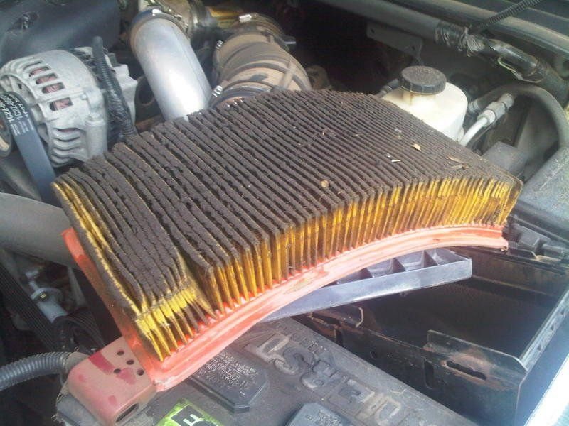

- Check the air filter: if it's dirty, clogged, or just older than 10-15k miles, it needs to be cleaned or replaced.

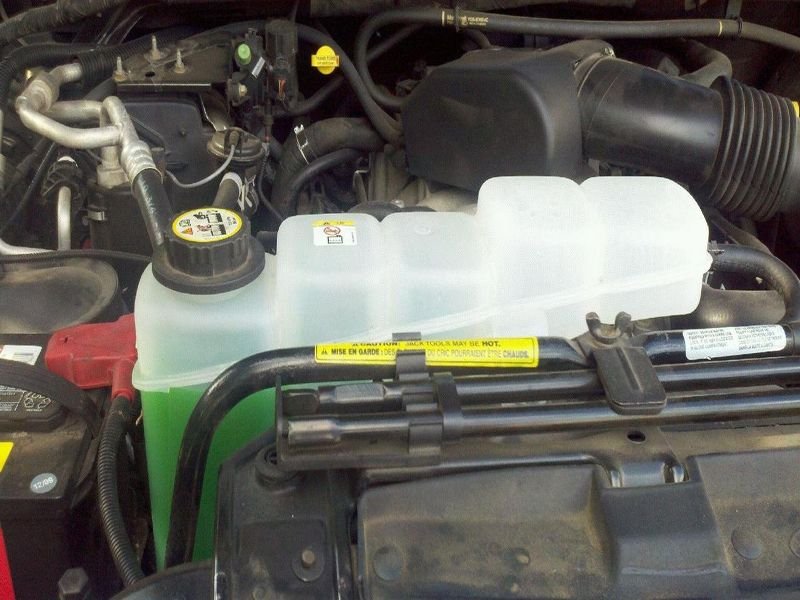

- Check coolant level and condition: an improperly cooled motor can lead to expensive problems.

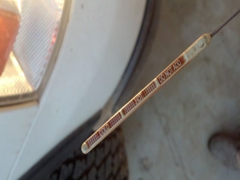

- Check oil level and condition: overtime oil breaks down and loses its lubricating properties.

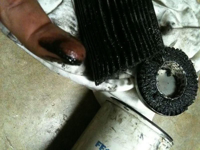

- Check the fuel filter: if it's clogged it will need to be replaced.
