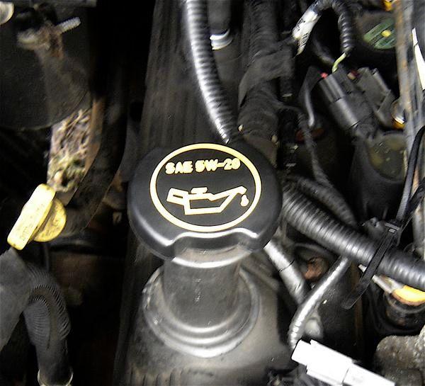

Locate your oil cap under the hood and remove it; be sure to know where your oil dipstick is, too. Because it's pretty hard to completely drain every drop of oil, even though you bought the recommend amount, chances are you won't use it all.
  • Insert your clean funnel into the oil fill tube (where you removed the oil cap). Fill up the oil to 1 quart less than the recommended amount.
  • Start the truck, let it run for about 10-15 seconds, then turn it off.
  • Using the dipstick, check to see if you need to add oil. If you do, add in small increments and repeat step 3 until the oil level is in the acceptable range on the dipstick.
  • Once the oil level is in the acceptable range, re-install the oil cap.
F-150 Oil Cap
Figure 10. Remove this cap and pour fresh oil (funnel recommended).
