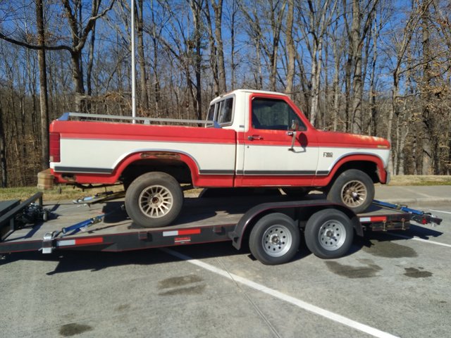

Here is what it looks like, I paid $900 for it, no key, no title (towed by the city for not having tag), but I can get one.
I bought this 86 F-150 I know almost nothing about. It has not run for at least a year I think. The oil on the dipstick looked a bit suspicious and dirty so I drained the oil.
At least 1 to 2 quarts of water came out first, then oil, and at the end some slimy stuff. Oil filter had some water in it too.
Are the head gaskets done? Could it be condensation ?

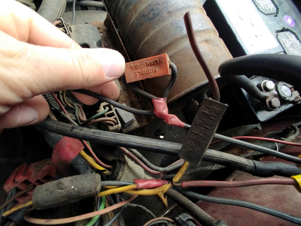

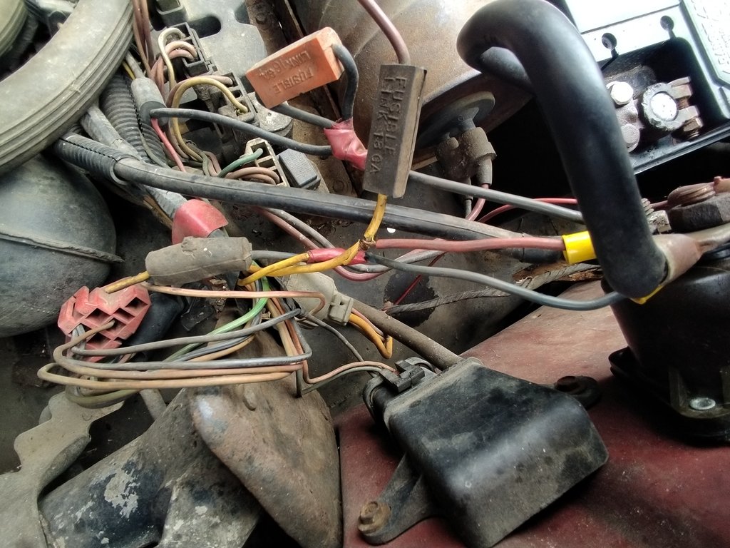

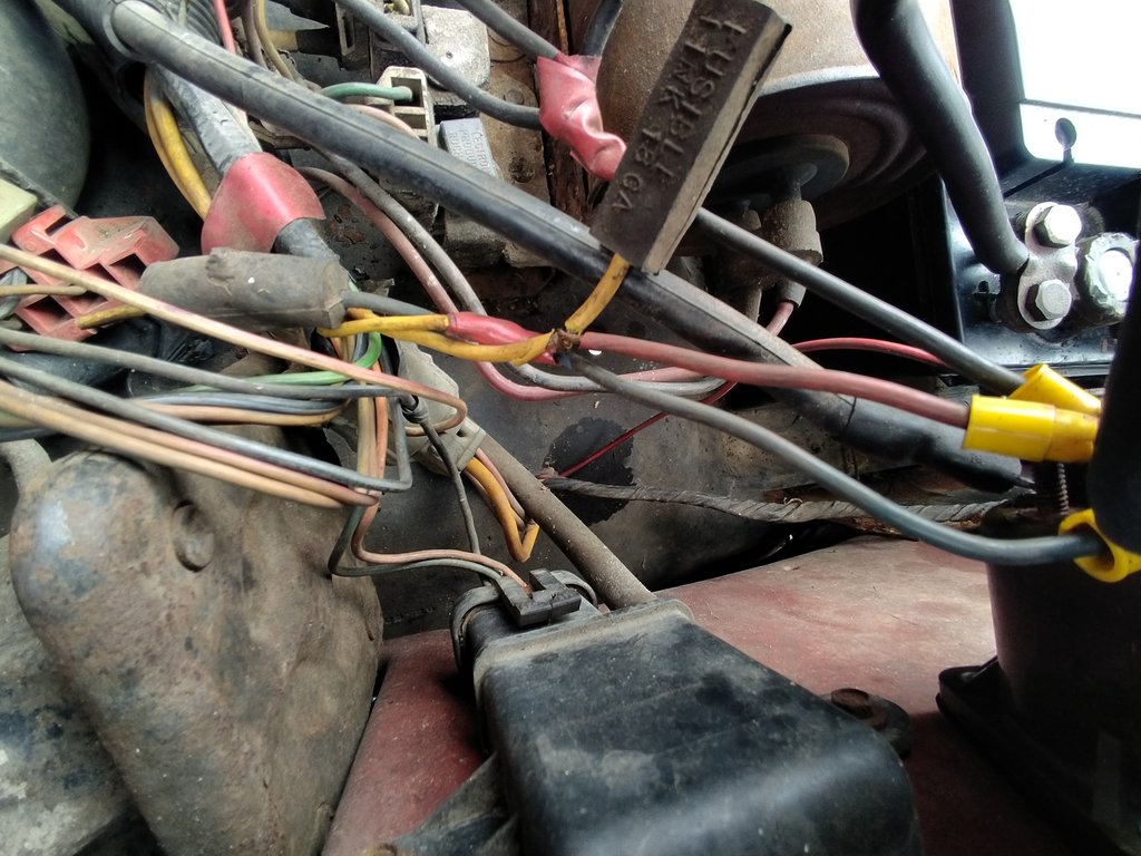

I don't know if this could be related to my issue but anyone knows what are these wires that are connected to the starter solenoid ? it look like the previous owner messed with the yellow wires and removed the fuse links.
photo upload

Fuse links are just like they say they are fuses that link to power.
They protect and feed different things in the truck.
The yellow one I think feeds power to inside the truck, fuse box and IGN switch so when you turn on the key you get power thru out the truck.
There should also be a black / orange wire with a link from the ALT to the solenoid. That is the charge / output wire from the ALT to charge the battery.
What the fuse link is is a slow blow fuse. When you turn on different things there is a high demand (amps) before that thing in on line. Electric motors, blower motors, are great when you first turn them on to go above the normal running amps and if a normal fuse was used it would blow every time the motor was turned on. The link will not blow (burn out) unless the amps a really high for a longer time.
My guess that 1 or both blew and someone bypassed them. I would replace them ASAP because if there is still a short it can then melt the trucks harness.
Now I just went thru this with a buddy and at 1 time you could get replacement link at your local parts store. Well he tried 3 different stores, I even went to 1 with him, and none had them
We then looked it up a Amazon and came up with a Dorman part number, went back in and they looked it up but there was no price listed so he could not even order it.
Because all the stores get their parts from the same place none would be able to order it.
Now NAPA maybe able to get them as they use a different wearhouse but we did not want to drive across town and I think they were closed anyway.
So you can order them from Amazon or check with NAPA. Note they have different blow rates like a normal fuse so you have to make sure you get the right size.
At 1 time you could also get a roll of fuse link wire but do you really need 25 ft+ of fuse link wire?
Dave ----
