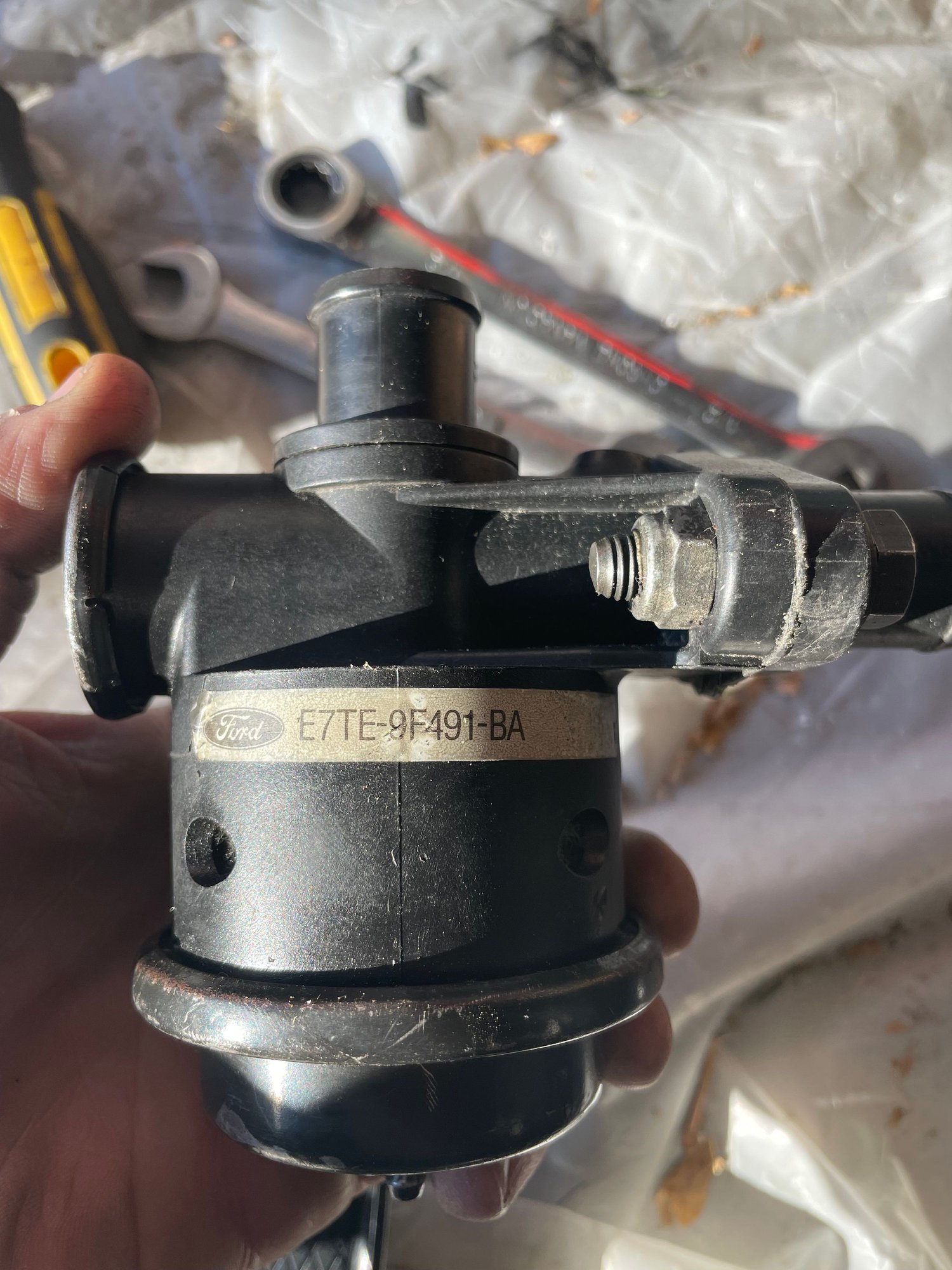

[img alt=""]Photo[/img]Looking for air bypass / diverter valves for a 1989 ford f250 5.8 351w

They are at the junkyard
They last damn near forever
You should be able to find a good one easily
Do you have a PCED for your year? So you can properly diagnose the TAB and TAD solenoids?
That is all I used to see, the occasional broken vacuum line or failed solenoid

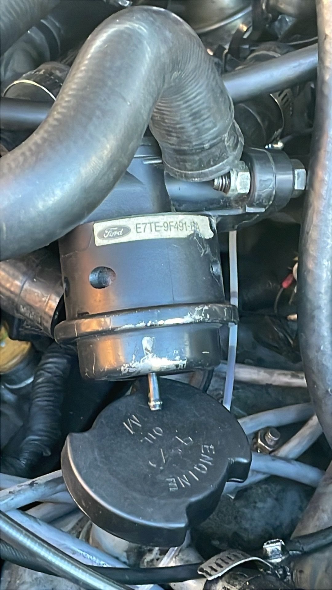

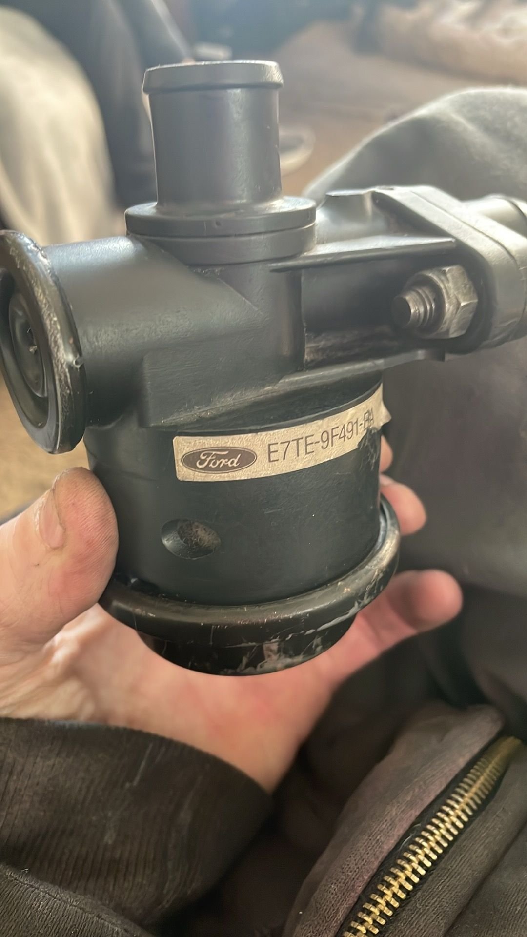

I’ve pulled the codes and first one was 33 got the Egr solenoid replaced, and I’ve got the tab solenoid replaced, now I’m waiting for the tad solenoid to get here on Wednesday, but my air diverter valve probably is not going to work because you can really suck a lot of air through the vacuum port, so I don’t think it will open when the vacuum hits it, does that make any sense, I’m kinda a bad communicator
