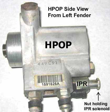

ok i noticed my ICP looked funny. online it seems people had what looked like a bolt on the end of it. mine has threads?
Old Sep 24, 2010 | 01:21 PM
broncxl302's Avatar
broncxl302
Joined: Sep 2009
Posts: 78
so i geuss the nut or bolt i am talking about thats not there is for to hold the sollenoid on? if that is a sollenoid. mabe this could be my problem i hope
Old Sep 24, 2010 | 01:37 PM
PaysonPSD's Avatar
PaysonPSD
Joined: Nov 2007
Posts: 9,549
Likes: 14
From: Payson, AZ
There are 2 different types of ICP sensors. One takes a 5/8" wrench and the other a 1 1/8".
Check the nut holding the IPR solenoid. It may be loose.
If you remove the IPR have new 0-rings on hand.
Old Sep 25, 2010 | 07:47 AM
broncxl302's Avatar
broncxl302
Joined: Sep 2009
Posts: 78
the nut wasnt there. went to homedepot and made my own. runs like a champ now. thanks guys for all the help
