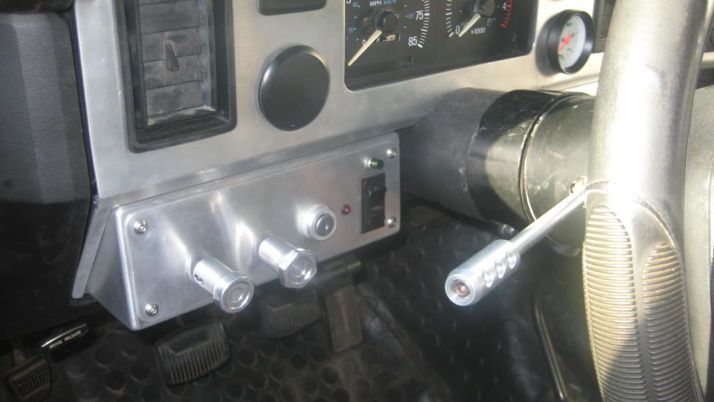

Then I whipped out a new shifter and transfer case **** out of some 2-1/2" aluminum bar stock on my dad's lathe.
Made a matching turn signal lever.

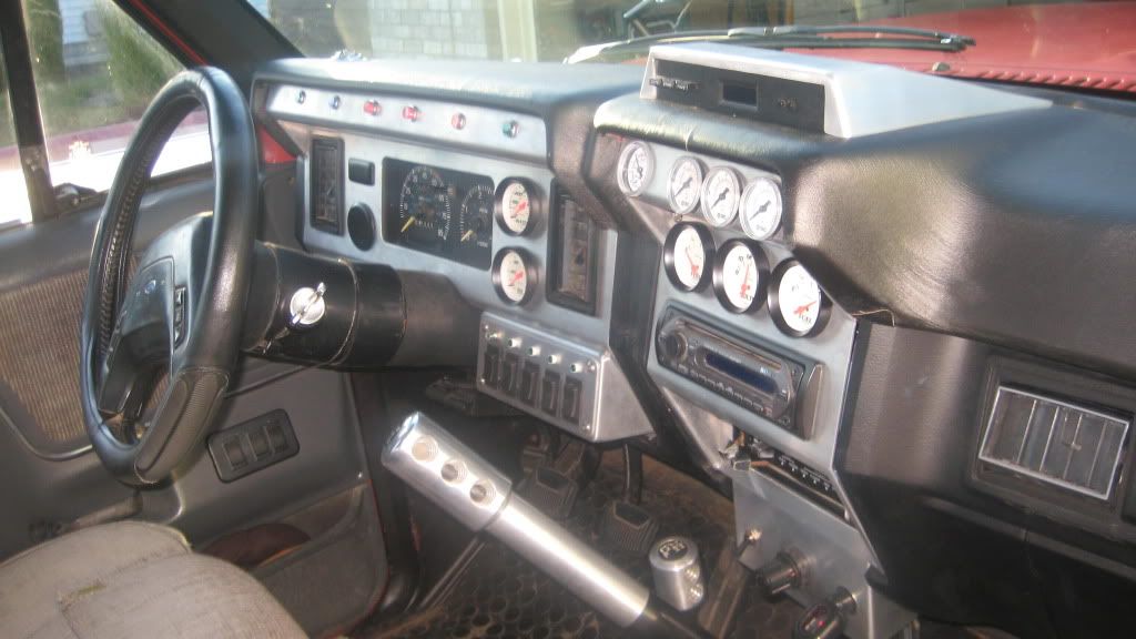

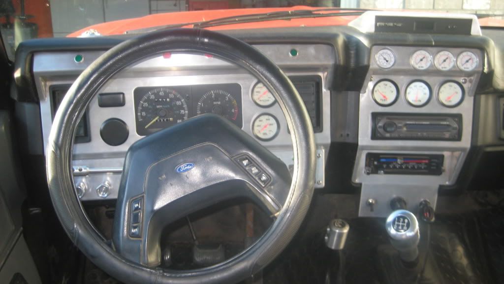

Then I decided I wanted more options - like more gauges, a tach, outside temp, compass, clock, more gauges, and controls for the air bags on the rear suspension.
I needed to plug that big ugly hole in the middle of the dash, so I fabbed a pan out of .080" aluminum that fit the stock clock and bolted it on top of the dash.
Then I snagged an overhead console out of a 99 explorer and mounted that on the headliner. Also got some visors out of a newer F150 so Momma could have a mirror on the backside of hers.
Then, after searching forever for a factory tach, I decided I would use the tach that came out the 89 parts truck - long story short - I got all kinds of carried away and ended up fabbing new dash panels out of .080" aluminum that now house a speedo/tach from a 89 along with a bunch of spots for aftermarket gauges. Also included a switch panel to the right of the steering column for cold start advance/high idle/electric fuel pump/fog lights. Then extended the rods for the wiper/headlight ***** so they were easier to reach, and gave me extra room for a aftermarket ignition switch and one more 3-way switch for the manual glow plugs and to engage the starter. Then made some billet wiper/headlight ***** on the lathe. The empty spots to the left of the speedo are going to be a boost gauge and pyro. Haven't got that far yet.
In the center dash, I relocated the stereo down about 1/2", giving me room for 3 gauges just above it. Then I added a vacuum gauge and 3 air pressure gauges where the factory clock would go. Then I deleted the ash tray, and built a panel that houses the cigarette lighter, an air switch, and regulator for controlling the rear air bags (will be completely adjustable from the driver's seat once I get on board air).

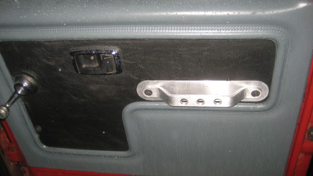

Finally found a set of rear door panels (that were beat), sanded and painted them, glued some more Ultraleather into the insert area, stole some door handles out of a Ranger, and made my own arm rests after my 5 year old daughter demolished a stock one.
