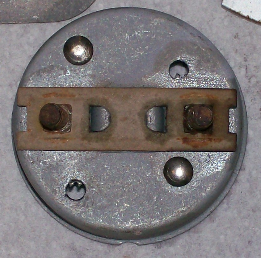

The alternative is to keep the electric gauge and adjust the needle down on the hot side. I'm not sure this will work since it sound more like a sender compatability problem than the gauge simply going up too far.
But, you can try it. The gauge has two holes in the back once you take the backing/mounting plate off. So what you'll need to do is warm up the truck to optemp, then remove the gauge from the cluster, pull it down from the dash and reconnect it electrically (without the mounting plate on it). Let it go up to "H" then VERY CAREFULLY use a very small screw driver to put in the alligator teeth in the hole and carefully twist the screw driver so the teeth move - which in turn moves the needle down.
Only problem with this is is the truck actually overheats some day, the needle may max out at a lower reading, and you'll never know you are ovrheating. This adjustment is a VERY FINE LINE! Here's a pic of the back of the gauge and the "Alligator Teeth" adjusters (2 and 8 o'clock):
