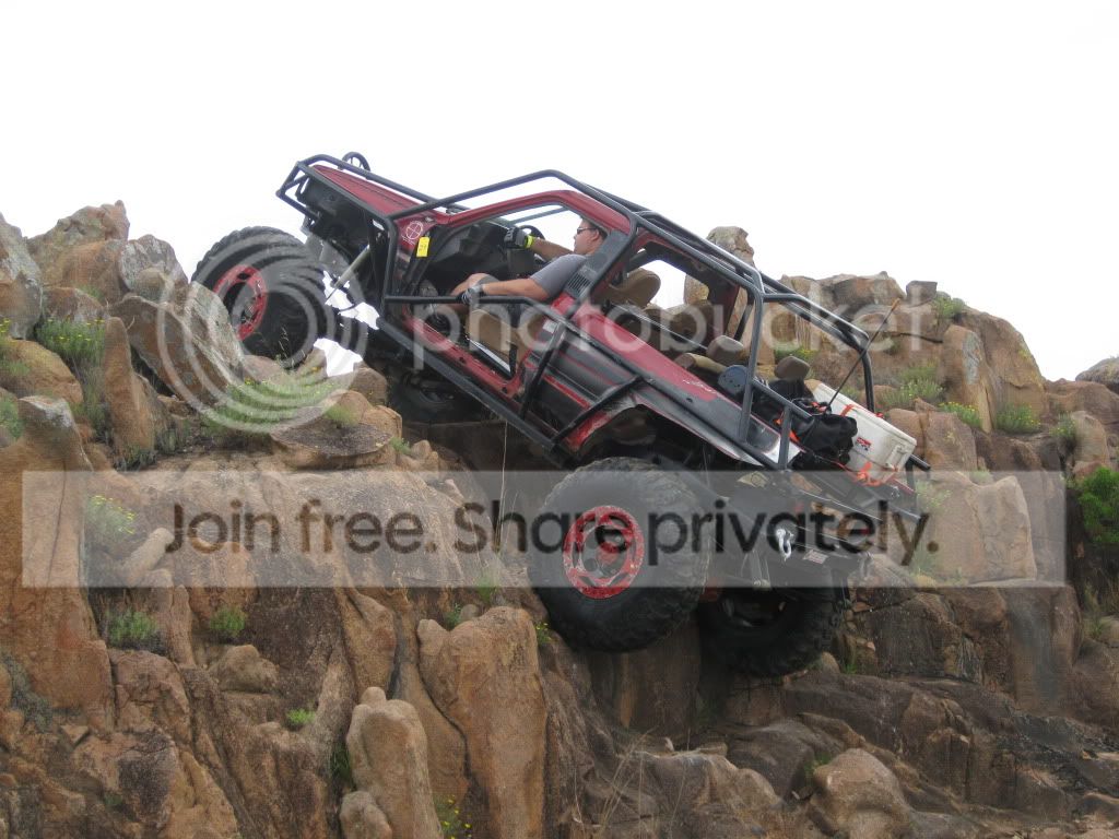

Originally Posted by DRM
Dana 50 knuckles and ball joints can handle 35's with a little more width and offset just fine - not worried about it in the least. FYI - I'm not new to fabbing or big tires/axles
Sorry for hijacking your thread, but sweet 4-runner. Is it on 1-tons? I've got a 87 on 1-tons and 39.5" Iroks. I'll be going to Pit Bulls as soon as I wear out the Iroks.
1 ton 60's front and rear - 39.5" Rockers. Feel free to check out my website, plenty more info on it there.

Awesome Yota there man. Here's mine 60 front and 70 rear.
Sorry, back to the topic.
