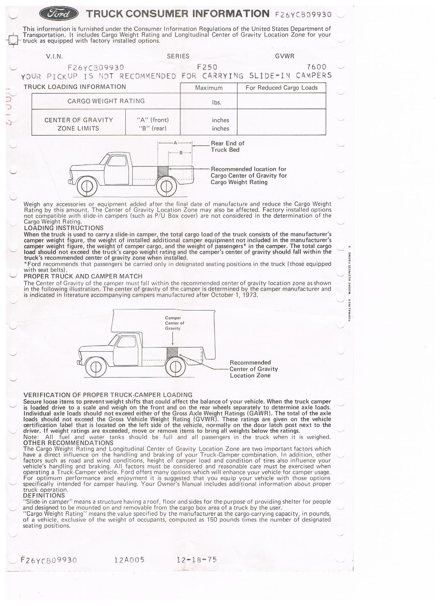

1976 f250 camper special
mine has this but the shocks on my truck say 8ts a non camper special

Overload springs were optional as were several different types of shock absorbers, so how you can say the shocks on your truck are not for a Camper Special, I don't know.
Most people in today's world haven't a single clue whether their old vehicles are all original or not. Most are not!
The ONLY way to identify a Camper Special: The tail lamp harness has an extra feed wire for the pigtailed wire/harness plug used with camper clearance lights.
This harness was placed inside the glove box at final assembly and is where it was usually stored when not in use.
If you want to know how your truck was equipped when new, you'll need a copy of the original build sheet, available from martiauto.com

There is no code within the VIN, or stamped on the Warranty Plate that decodes to a Camper Special.
