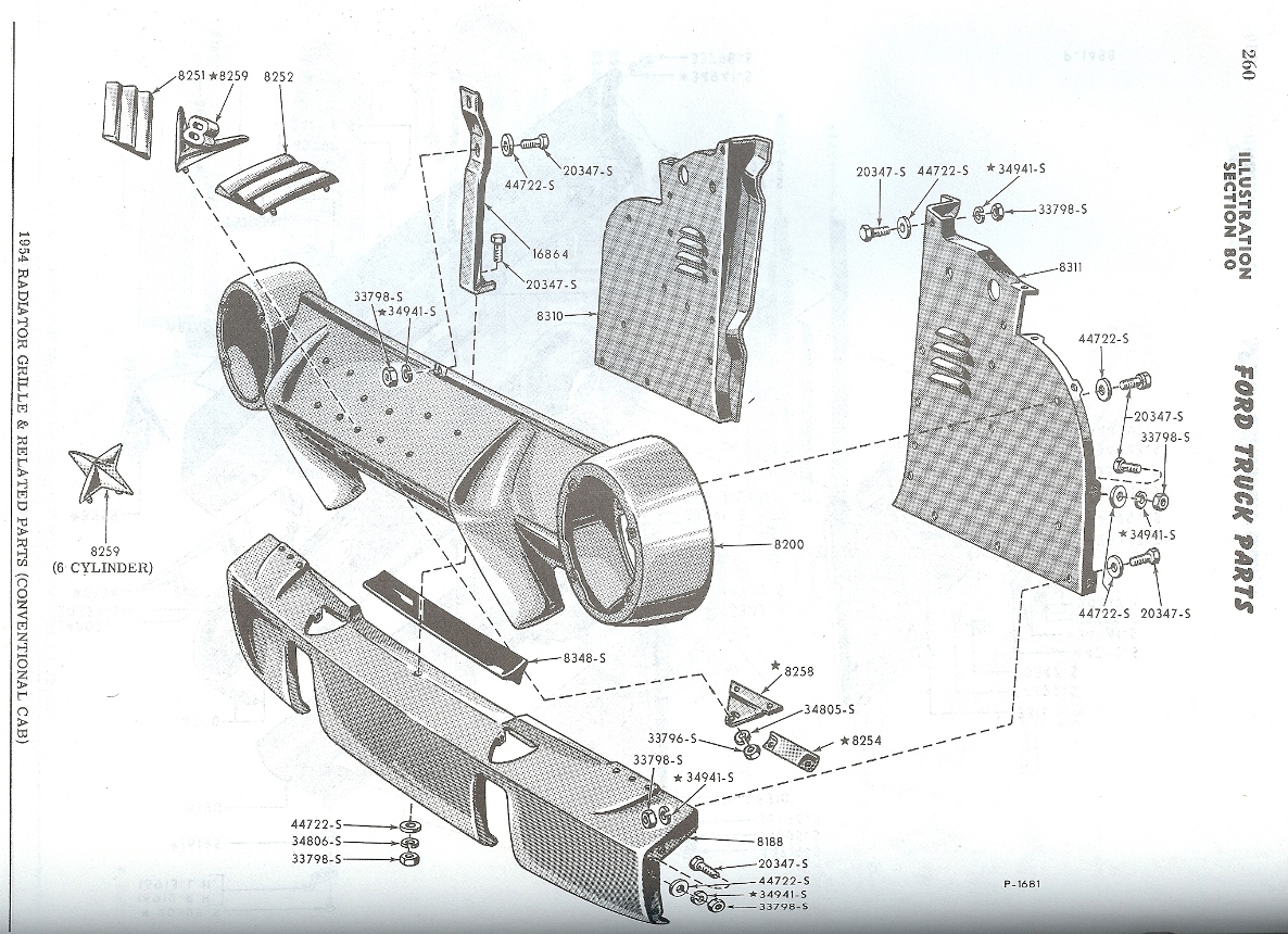

I think it's different including the grille - 51/54 parking light are the same and 55/56 are the same. The 54 lower valance has cut outs for the sharks teeth like our 51 52s
My 55 had some gaps around the parking light lenses too - about 1/8 inch!
Here's the scans of the 54 and 55 front sheet metal:

the '53/'54 park lights are pointed, they have a peak in the middle of the lens. i have some aftermarket '55 park lamp asys but the mounting holes to the gravel pan are off and the butchered holes in the air deflectors are off (but inside the housing so you can't see them with everything on). i wanted to make sure before i started beating and welding it into submission.....

Your 53/54 parking lights are the same as those on the 51/52!
It sounds like the PO got crazy with the drill to try and make stuff fit!
