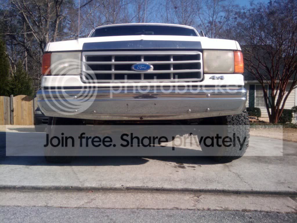

Originally Posted by fatdan460
what is the ttb hate all about?
I have one simple thing that can answer that:
