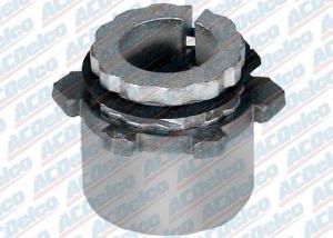

Ok the castle nut with the snap ring is NOT a nut. That is your camber bushing :
It goes here:
You shouldn't have to do anything with that right now. If both castle nuts are off (top and bottom balljoints) all you need now is a big F'n hammer. turn the spindle away from the front of the truck and give the inside bottom of the spindle a hard wack. the spindle will fall off. the ball joints are attached to the spindle. After the spindle is off then you can remove the now mangled camber bushing.
When you are ready to re-install the spindle remember to tighten the bottom balljoint first (Very Important) then put in the new camber bushing and tighten the top. The bushing needs to be able to turn in order to align the front axle. If you tighten the top the lower joint wont seat.
