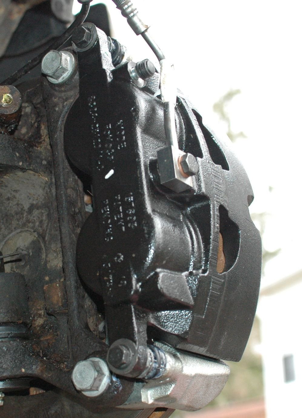

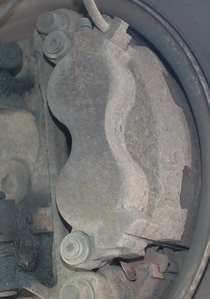

I'll add these photos from a project on my 2003 E-250 converting to 2008 and later front brakes:
Original calipers:
2008 Calipers:
It would seem depending on year and chassis caliper slide bolts may NOT be just one type fastener.
