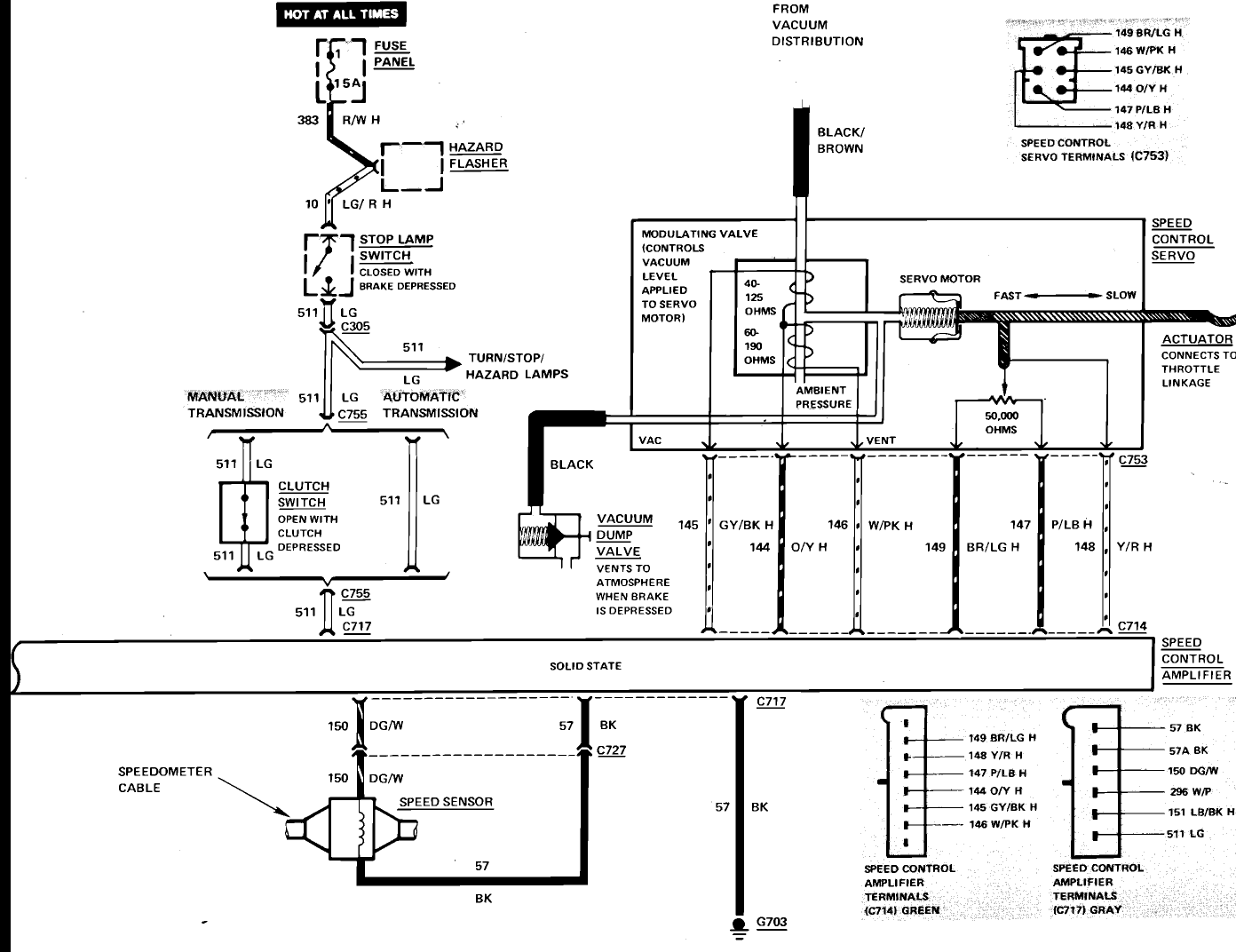

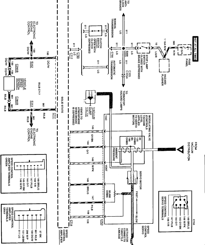

Old Mar 17, 2010 | 06:43 PM
swooshcmk's Avatar
swooshcmk
Joined: Apr 2002
Posts: 950
From: West Bend
I've got two here. One for an 85 F250 4wd with 6.9 and one for an 88 F250 4wd with the 7.3. Should have you covered!
First up the '85
And the '88
Hope that helps!
Chris
