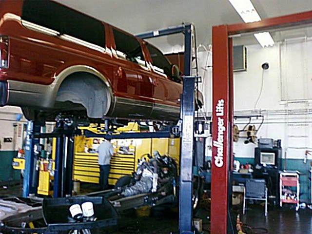

That's getting it done body off. Some guys have done it without raising it. Prices range greatly($1000-$2500 labor only), as does quality of install. If you ever loosen a head bolt/stud on a 6.0, you should change the head gasket.
Get the EGR cooler delete installed while you're at it.Shouldn't even cost any extra in labor, as the top of the motor will already be off.
