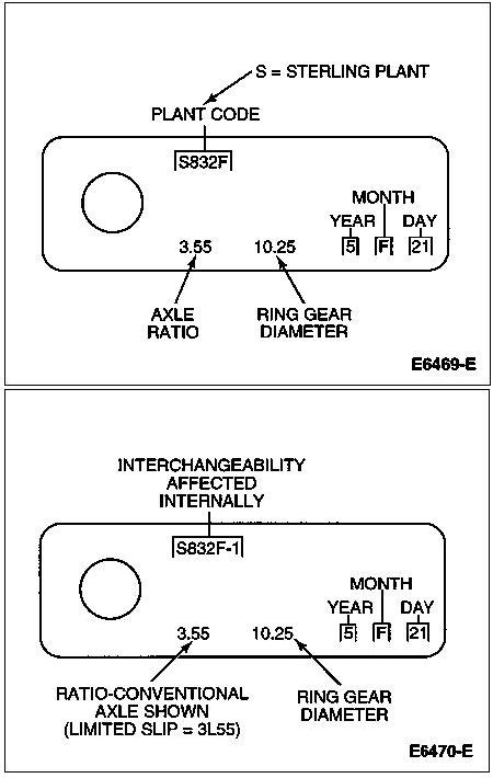

This is from the service CD (the picture is attached):
Ford Axle Identification Tag
The plant code for an axle denotes a particular design and specific ratio, and if it is a conventional or limited slip type. In addition, the plant code will not change as long as that particular axle assembly never undergoes an external design change. If, however, an internal design change takes place during the production life of the axle and that internal change affects service parts interchangeability, a dash and numerical suffix will be added to the plant code.
Note that plant codes in the illustrations are identical, but the tag below shows a numeric suffix. This means that as an assembly both axles are interchangeable; however, internally they are different. Therefore, each would require different internal service parts at service time.
