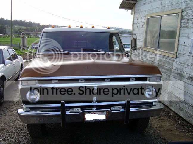

The wrecking yard owner is almost right...most parts will interchange between '67 and '72, so a '72 hood will indeed fit but the '73 was a new body style and the hood won't work...sure he's not trying to sell you the hood off a '73? The turn signals aren't mounted in the hood on a '73, but they're above the headlights instead of below them like they are on all '67-72 trucks.
1972 on left, 1973 on right
