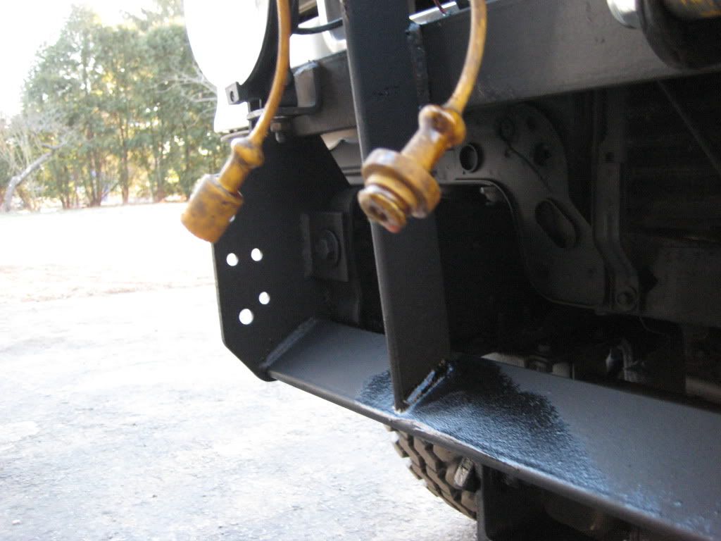

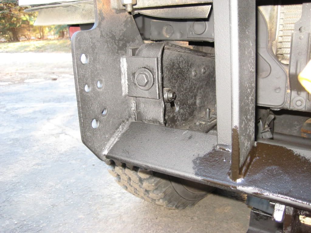

The front frame sections arnt the same. On the 91 down the frame is a c channel in the front, not boxed. The 92+ are boxed in the front.

Here are pics of the 2 different setups, you will see that they are very different and cant be swapped.
92-97
80-91
