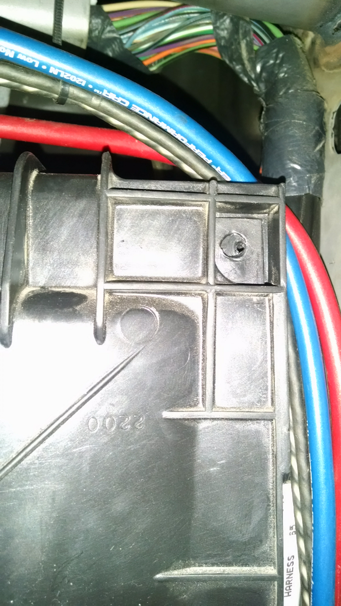

While I was in there I removed the core box cover. Coil was clean. Put it all back, and glovebox wouldn't close completely. If you remove the core cover, the upper right corner does not just lay on the face of the box. The corner of the cover slides behind the corner of the box. The core box is flexible enough to manipulate into the cover without removing the lowest 2 cover screws.
