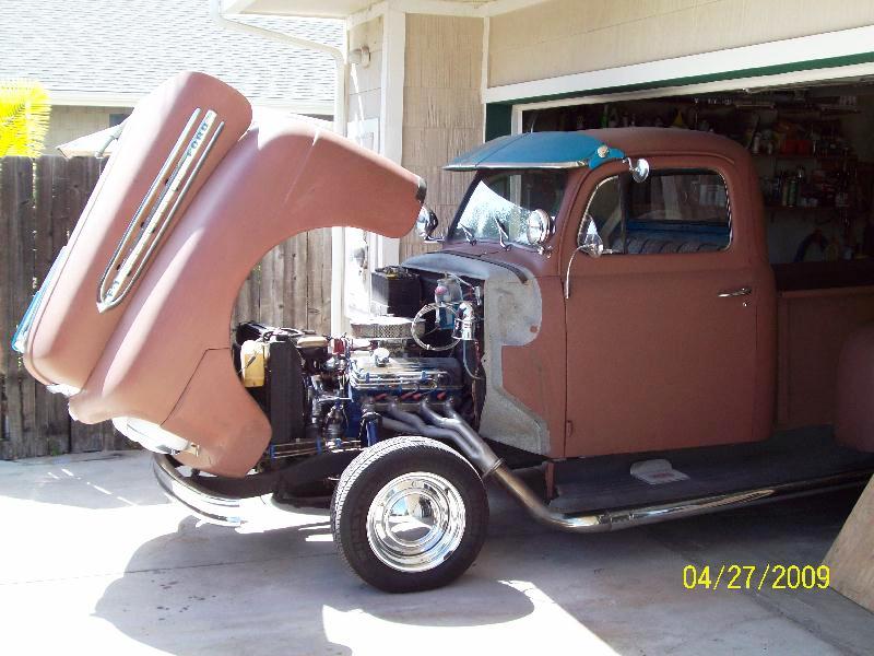

Has anyone ever done this....You mean THIS????
Name:  C Outside View April 2009 1.jpg
No, why?
Ok I'm just being a smart butt.
I have done it, I have tons of pictures, and a MS Word write up on how it was done and lessons learned.
You don't have enough posts to send PMs yet (you need 25) so write me an e-mail at babbiebuddie@***.net and I'll send you the whole kit and kaboodle!
PS It's all the original steel btw.

Julie,
That is way more than I was thinking. Pretty cool though and I am interested in how you got that accomplished. I will be emailing for more info.

Originally Posted by Julies Cool F1
HI JEFF!
Welcome to FTE!
Attachment 19106
No, why?
This is awesome. I sent a email. Hope you still have the same email address.
