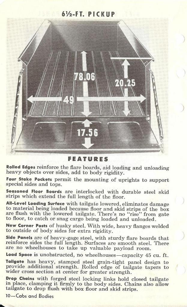

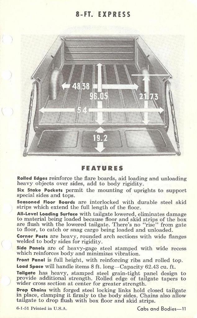

Here' some pictures.
Only problem with shortening a long bed is the wheel wells will not be centered. And if you put it on a 114" wheelbase frame, the wheel wells will not fit over the wheels running boards will not meet up etc. You'd have to do it on an F2+ and shorten the frame in the back as well. Not sure why you would want to do such a thing kind of making a mess for 1 1/2 inches in height and acatually reducing the width between the wheel indents.

Thanks for the info
Well, I still have to adjust my frame... and I'll be making this bed from scratch anyways, so all the custom problems aren't really an issue. I'd just like to see one done before I commit, ha.
