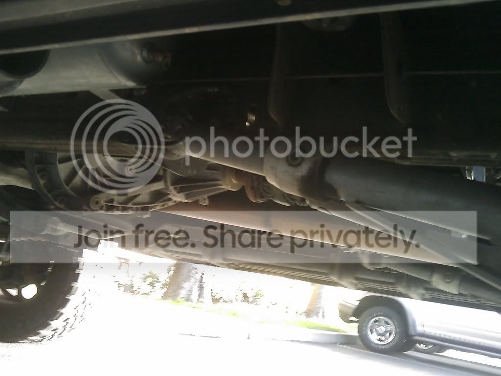

I don't have any pics of the front attachment. I'll get some and post them for you later today or early tomorrow.

Front pic with a crap camera phone...
I believe they were around $500.
