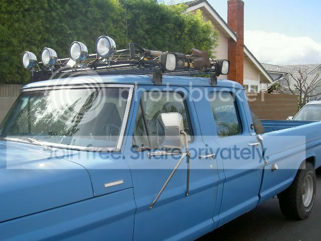

What and improvement the new lights are! They put out the same light as the new truck's! Here's what I did, order the Hella lights from summit $100.00, these give you side light as well as long distance. Ordered wire harness from LMC $30.00 installed easy in about 20 min's. Powermaster 140 amp from Advace Auto $185.00 also easy to install remove voltage reg. and unplug wire harness. New alt come with one wire hook up. I did call rep at Powermaster he said that's all there is to it. He also told me how to wire in dash alt. light too, very simple. Best inprovement I spent on the truck so far. (me and my old truck- two old clunker's)

picture of the relays for lights

new alt. only one wire the red one go's to + side of batt. The blue one you see was the lead wire for the starter.

you might want to think about a better grounding wire from the engine to the body/frame, i dont know what you have but it should be atlest as big as the red one, or i could be wrong but it is what i would do.

Thanks for your concern, there is a large ground wire from batt. to motor and to frame. I'm a nut when it comes to grounding, root to most electric problem's is poor gounding.Thanks
