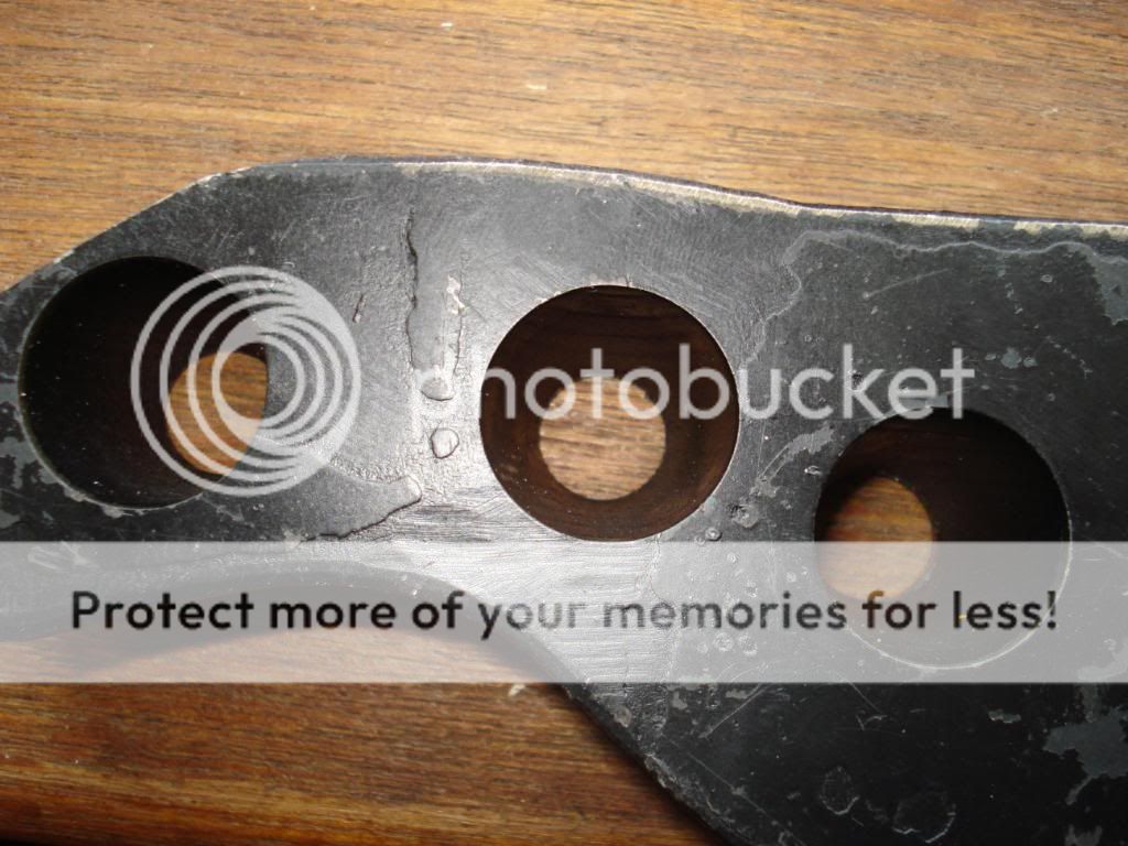

If the shoulder of the stud is the same length as the shorter one, the stud cant provide enough surface area for the steering arm to make contact. This means that you will have a weak point. Thats what the shoulder is for. More contact area means more strength. Touch the surfaces with a threaded surface and both the stud and steerin arm will be comporomised and it will fail.
What material is this steering arm? IS it an aftermarket arm? Why is the drag link making contact with the spring pack? Has to be some circumstance that is making this an exceptional install.
Welding stuff together is probably not the solution since the problem is simnply being able to apply enough clamping force to maintian a reasonable amount of torque to the fasteners. Keep in mind that these arms are under a pretty severe load and this load is a side load and the studs are always in sheer.
Welding will undoubtedly warp the mating surfaces and the lack of flat surface will require that the studs do more work than necessary to clamp all of the parts together.
This is why we do not see arms powder coated or painted. The surfaces have to be as close to a perfect fit as possible with no deviations.

You are more than welcome to weld if you wish. Any amount of heat will distort the machined surface.
Case in point:
I am currently re-building a Dana 60F and found some simple discrepancies with the short side tube. Made some aluminum slugs to simulate the carrier bearings so that I could pre-load the caps. Bored a hole through the center so that a long boring bar could fit through the entire axle. This was used to determine whether or not the axle housing was straight. It was not. Turned out that the previous owner welded some stuff to the tube and the heat generated by the welding pulled the tube almost .177" in one direction. This would have been enough to cause a leak in the inner seal.
Could this be tolerated? Perhaps. WOuld it have leaked for sure? Maybe, maybe not.
Is leaving it the absolute best way to solve the problem? Not in my eyes, but I am just one guy and opted to put it on a jig and straighten it. Simple approaches provide a much better long term solution.

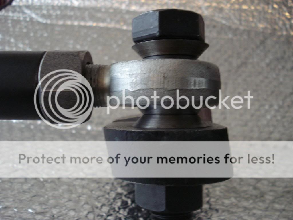

In your case, instead of re-engineering the steering arm, you have a shperical rod end that is easiest to use a high mis-alignment bushing and a different bolt to attach it to the arm. This mis-alignment bushing will provide additional heigth and solve your clearance issues. Since you uare using a 3/4" bolt you should have no problems with the load. You may want to increase the sixe of that shperical rod end, and then use a strong 3/4" F911 bolt with the appropriate high mis-alignment bushing, and you dont have to get so creative with the arm Your studs will be fine and you dont have to worry anout it coming apart.
These insert into a larger rod end, and create a stronger joint or union when compared to the little spacer things that you have there.
These can be machined in Stainless or chro-mo. I use chro mo, but stainless is popular.
Notice the rise that one can expect from this set up. You may fint that this will solve your problem. YOu dont have to buy three studs or weld a spacer, just the right rod end and hardware. This is more reliable.

yes good idea.I dont need the extra angle that these create.i know they give hight too.If i were to use bigger ends with the same bolt then the arm will need to be drilled even bigger/weaker.I have bolts that are maybe stronger than F911's and are press fitted in to pitman and steering arm ,zero movement.
Those were machined up and cost alot The shanked part is perfect and all spaced out for safety washers and all.So cant space up there.There must be plenty rigs running the spacer.Otherwise i must make a new arm but will still need the longer studs.Would grade 8 studs in your opinion be strong enough.Here they are called 10'8 also get 12.8.

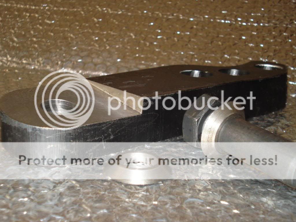

If you use the high mis-alignment bushings the hole for the arm is actually the same size. It will remain 3/4" even though you might be using a 7/8" or larger spherical rod end.
See the spacer is actually an insert. You insert the spacer into the top and bottom of the ball in the rod end. There is an OD and an ID of the spacer. The OD of the spacer is just under the ID of the rod end for a perfect fit. The bolt hole is reduced from say 7/8" to 3/4" so you will have the same sized bolt.
The 3/4" Grade-9 F911® 190,000 psi Bolts are stated as the strongest in it's class which is the reason they are used in the Aerospace industry. The 8640 alloy has 56% more Chromium & 100% more Nickel than other Grade-9 's. Bolt heads are 30% thicker. The smooth shoulder is also extended to provide maximum contact surface to the knuckle/rod end rather than against the threaded portion for a secure fit.
Have only seen one broken bolt ever. This was a vehicle involved in a crash that was insane.
Here is what the bushing looks like installed:

Well I hope that the idea worls out for you. I believe this to be the safest and strongest route.
I think I recall a conversation not long ago. Your stuff is metric right? You had all of these things custom machined? Why was that again? Is there a reason why mail order stuff cant work for you?
I can send you some dimensions of the misalignment bushings and you can actually have some made. So far you have some serious machining being done, a set of spacers like this should be a piece of cake.
I also had another thought. Is the drag link close enough to the frame on the driver side to help your clearance problem? I mean if it is too low because the pitman arm is dropped too far, you will have a clearance problem on the pass side. Could this be a contributing factor?

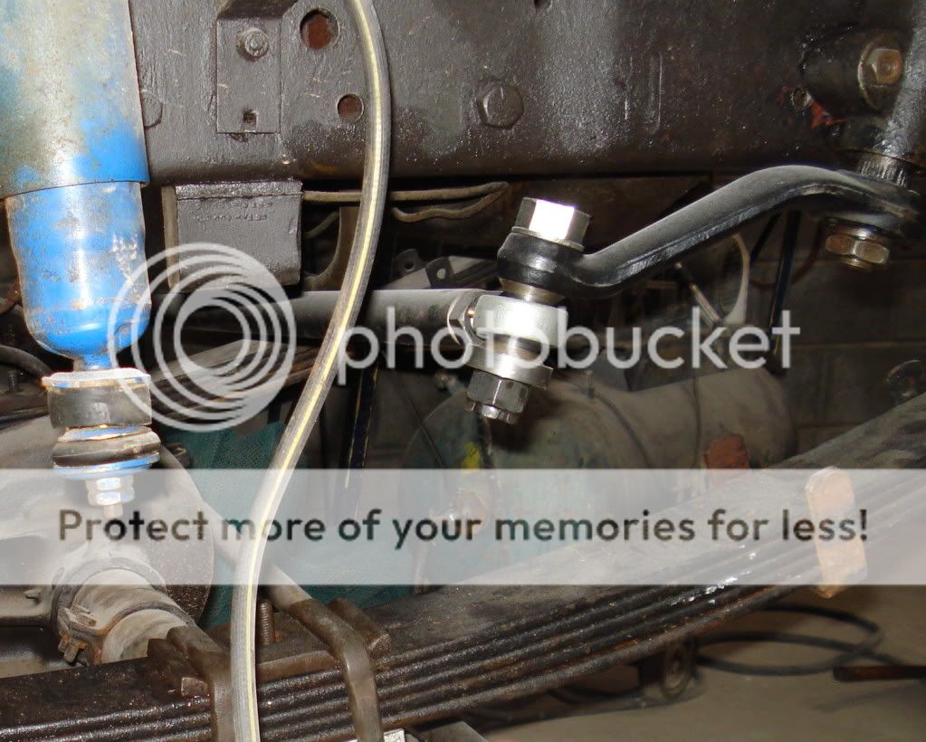

I have morel ift than you do, but I have more leafs in my spring pack as well, almost twice the amount of leafs pictured above.
I run a D 60 up front so my knuckle is larger and this additional heigth might make this an apples to oranges comparisson.
I dont have much clearance between my spring and the drag link. Since the knuckle and drag link move exactly the same, there is never any trouble with clearance. The steering box side is another story. I run this side as tight to the frame as possible. I still hit the pitman arm with the spring when compression gets crazy sick.
Pinion angle in minimal. This was from many moons ago, but it is the best shot of the angle that I have. I keep the angle to a minimum, and the pinion points right at the tcase. Not an up angle and not down like the low pinion. This permits the widest amount of movement without binding when the suspension cycles.
I have run both, doubles and singal cardans with the same angles. The 1350 double cardan has an advantage under extreme suspension extension but the larger 1410 single joints can work at greater angles, so this boils down to which joint can work at a given angle and how much your suspension can cycle.
With the very long front driveshaft, the driveline angle is seldom a problem. Caster is more critical than anything.

It is much better to have them. My rigs are maintenance machines. They come apart all of the time, and I replace spherical rod ends after a given season. If I impact a component, it gets replaced.
This set up has since changed and I do run a saftey washer. If you have them use them just make sure that it does not bind the rod end or it will promote problems and stress the ball to the point where the saftey device might actually cause the rod end to pop off.
This is where cycling the suspension become critical.
