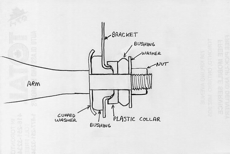

I don't know if it was a factor or not, but the bushings look to be incorrectly installed. That looks like the white plactic spacer on the face of the bracket. It should be on the back side.

Once the parts come in, I will check the assembly per the drawings. The exhaust team up into this collector/resonator, then go into the cat, and then to the '33 gallon muffler.' (Next mod, for certain.) I'm just wondering how much grief this fix will be. I will def pre-soak the connections. (I'm working on the street, in the city, no access to a shop...)
