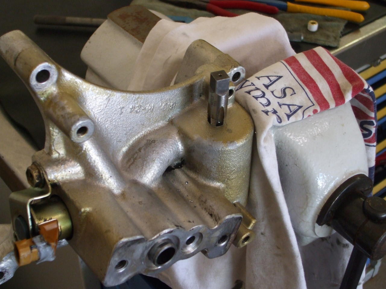

Sorry to bring up an old post but I have questions. I am looking to do the ebpv gut but I thought the plug everyone was talking about was more then whats pictured above. I want to plug the oil port to the actuator reservoir so I could leave the solenoid plugged in but it wouldn't do anything but keep the computer happy.
Any info out there on something like this, or does everyone just do what is pictured?

A machinist could fab a tube, or plug, that would press inside the pedestal bore and block the ports. There are also plugs on the outside of the pedestal for the passages that were machined leading to these ports. It may be possible to block those passages through these accesses to the ports in the bore.
