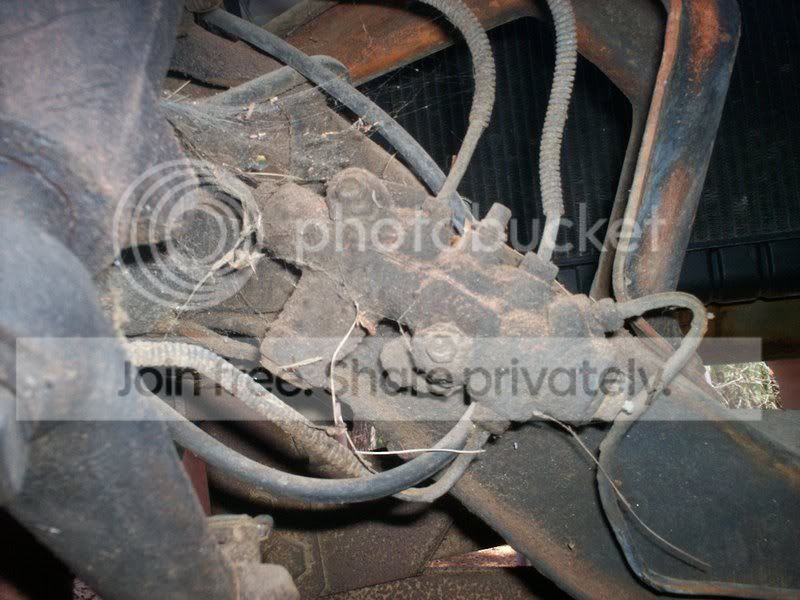

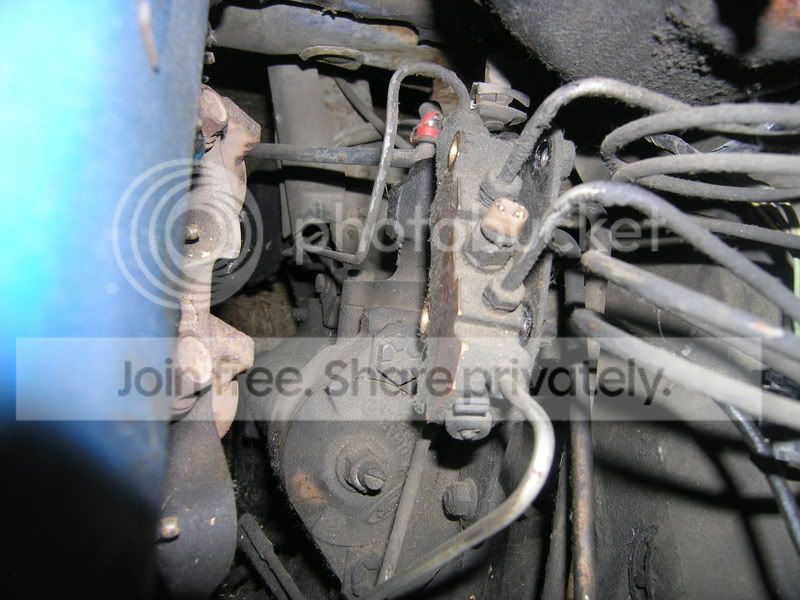

You may want to get the ( Wide Brake pedel ) also ,even if you think you don't want it now you
may want it later ! It is easy to install . As for the ( P.valve ) I did not use the one on the steering
box , I thought it was to close to the ( Headers ) !
https://www.ford-trucks.com/forums/7...-question.html
