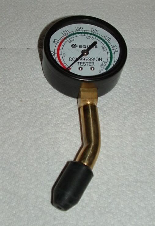

I forgot you can also you a press in style, but you would almost need a second person to do it, here is what they look like:
Screw in style:
Press in:

Both styles of gauges are cool for different reasons; the hose is flexible and gives you a
bit of freedom to move around. The press-in one is fast to use.
