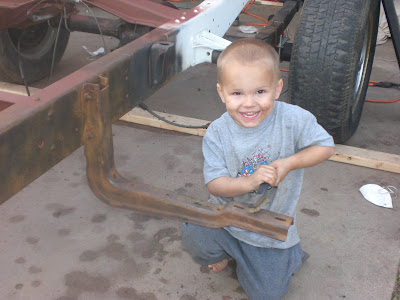

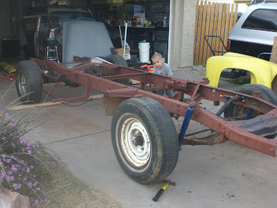

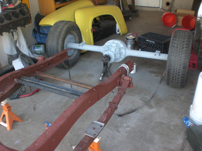

With the cab off, we started working on cleaning the rust an grease from the frame. My 3 year old is a great helper and we stripped it down, scraped and flap wheeled it as good as it was going to get without sandblasting. I fixed the rear two crossmembers and bolted them in place for the first time since I bought the truck. Took out the rearend and primed it. After that we laid down some red oxide rustoleum "Heavy Rust" on the entire frame.
He loves this stuff...can't you tell?
9 inch out...still need to put in those crossmembers at this point. Just bolted them in with grade 8's

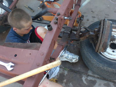

After it was all primed, my 11yo helped take apart the front axle and I got to teach him about the beauty of "leverage" with the help of my trusty breaker bar. He got it off after some work!

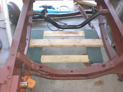

Front end sitting on a modified furniture dolly so I can work on the front axle for a while.

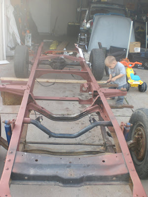

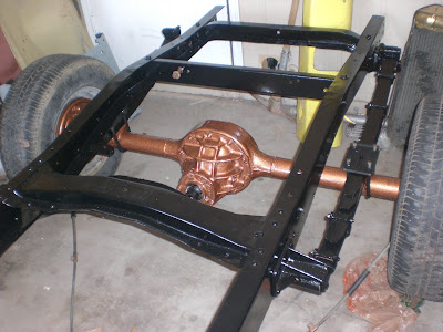

Decided the front end needed some more work but will have to wait for another day... so we set out to start painting the rear half of the frame.

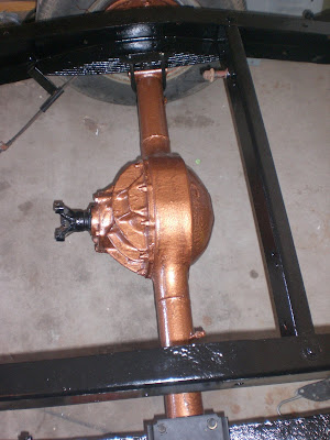

Went with Rustoleum Industrial paint. Gloss Black. $31 a gallon at Home Depot. I think it turned out really well using brushes. It was oil based and we made a mess on the driveway...whoops!

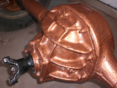

We painted the rear end the night before the frame using Rustoleum "Hammered" finish in Copper. I think it turned out pretty snazzy. (the truck will likely be a copper color as well) I am going to do the front axle this color as well.
I will have to grind some paint off when I get my lower shock mounts (they have to weld on)...but I couldn't resist painting it now. I can touch it up later.
Crossmembers are in...
The pictures don't do it justice... when it is in the sun it looks even better!
