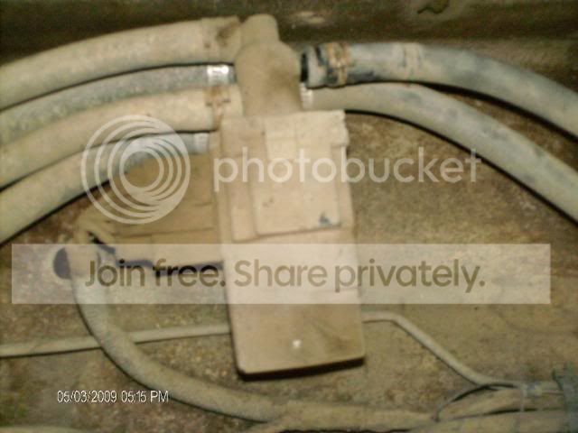

Originally Posted by trucker101
Is this a fuel filter?
It's the only thing I can find that looks like one. I took it out & blew it out with compressed air even-though it was clear.Reinstalled it,engine runs a little longer than before.
I took out the fitting in the red box from both float bowls.
(1)From the front one,while cranking,at first gas was comming out but had lots of bubbles,then just gas no bubbles.
(2) Rear bowl lots of gas no bubbles at all.
Green Box
This is the gas line in.I could not undo the fitting but I think a filter lives in here. This line goes to the fitting in the other picture I posted.Because this this a Van class C motor home I can't look down the carb,can barley move my hand around in there.
the first picture is your fuel pressure regulator the second line coming in the top, is not a supply, it is a return line to allow unused fuel pressure to return to the tank.
the thing you blew through is the only fuel filter
I would replace the regulator before i tried rebuiling the holley
I just replaced mine and added another filter to the line. Used one easier to get to and clean.
the stock filter has an inserted filter media that can be removed. i had to destroy my original filter element with a pocket knife to get it out but the replacement was only about 8-10$
Ps my problems came from the truck sitting idle and rust from the tank got into the fuel lines. the filter i added is glass and easy to get to so i can clean it as needed

Old May 18, 2009 | 04:14 PM
Eddiestruck's Avatar
Eddiestruck
Joined: May 2009
Posts: 49
From: Greenwood S.C.
The pic above is your tank selector switch.
Pump in the tank is a dumb idea but it's what we all face now.
Reset switch will only feel like it is resetting if it is tripped.
