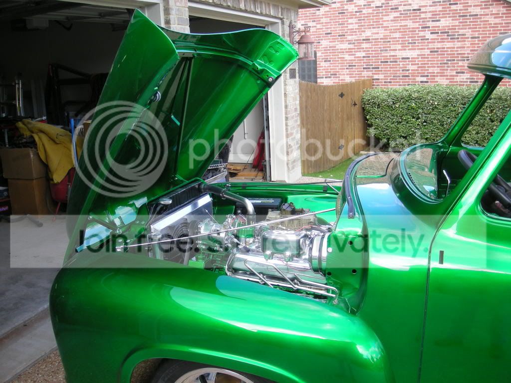

Sam, do you really have a 460 in that little F100?
yep (pre-running pics)

OMG that is amazing. And heck, I thought I was proud of how well I did rebuilding my carb, and now that I see your engine compartment I am once again humbled. You sir, I should bow down to.

Wow Sam, that does look great. (despite that dirty ol Holley carb) Very nice - I'm jealous!

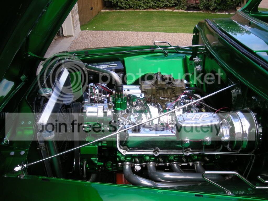

thank you.. mind you the dress ball milled valve covers aren't installed yet, the polished carb and oval air cleaner are missing too. (less to mess up while testing).
here is a pic after the engine paint with the fancy valve covers on. (before we painted the distributor cap too.. that blue is FUGLY)
all the engine wires come up from the tranny tunnel (using weather proof connectors to unplug the harness) thru a (to be polished) stainless pipe along the top of the polished intake. (you can see the plastic pipe prototype in the second picture) with hidden cutouts for the oil pressure sensor wire, and choke wire. very little of wires will show in the engine bay.

this is supposed to be THE ONLY hot lead back to the main harness. but in my case the battery is connected to this same lug (battery, alternator and main harness lead,) oh, and the alternator sense wire is on the far side of the fusable link.. such that when the link breaks the alternator cannot sense its output, and turns it off..
