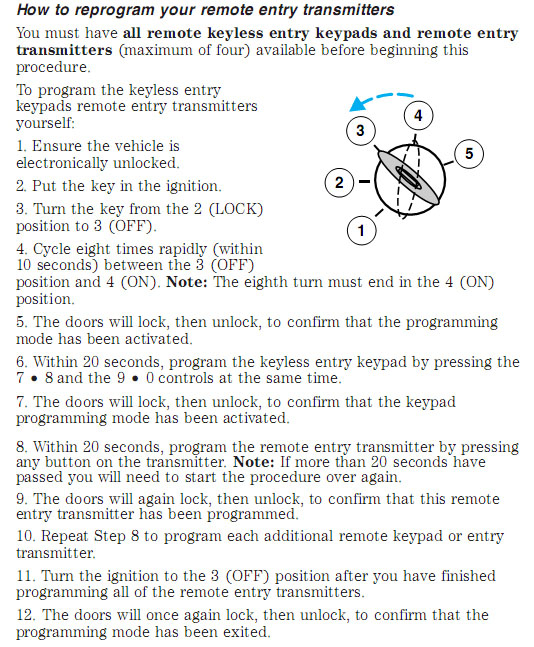

Can someone tell me how to program the key fobs.
I just picked up a 04 f250 cc lb fx4 with keyless entry and it came without any key fobs.

Should be in your owner's manual. I just slapped this together from the pdf of my owner's manual. Hope this helps...

My 2003 had electric door locks,but did not come with remote entry. Had to purchase a remote entry. Get a build sheet for your vin number and it will tell you if you have remote entry. You can ask your dealer for it. or ask Ford, but the FTE Parts Guy got mine for me.
Ed is really accommodating. You might ask him. He is a sponsor here.
