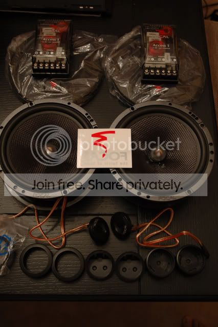

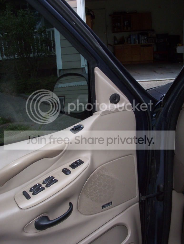

Definitely go for the 6 1/2 components, I did and am very pleased with the results.
That alpine deck is fine it's a good unit.
Delete the rears or run them off the deck itself and amp the front components I used a 150 watt x 2 to keep it clean. I find I just leave my rears off now.
I see the woofer mount is nice and high in the door on those so I would mount the tweeters in the pillar against the windshield bouncing sound towards the opposite seats. (I wish I had done this as mine are in the sail panel but they still sound great)
I went with a used focal set and the highs are amazing and bright: Access A1 $100.00 used and about $240.00 new.
Now the tweeter (and everything else) in these are much better but the price was way too high for me.
Focal 165 K2P - Focal 6.5" PolyKevlar Power Components
Crossover no higher than 80 to the components. The lower the better as bass becomes directional after about 60hz. My focals run down to 65 hz for example so 75 would be perfect for overlap of the slope. Leave the high pass filter off (amp or headunit) if it's higher than 80.
Use dynamat on doors and mount speakers professionally, it makes a big difference, small speakers can hit hard.
Happy Rockin!
