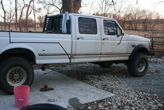

How do you have your exhaust system set up? I see you have it exit in front of your rear tire. Any sound clips? ==What is with the last picture? I don't understand what I am looking at.==
I just ran a straight pipe from the 3" turbo down pipe, bent it out 60 degrees and put a chrom tip on it. The chain in the picture was temporary. I used that for a couple of weeks along with baling wire until I devised something I wanted w/ a bushing. Now though, I'm back to just my stock turbo downpipe, and its loud as hell. No sound clips yet. I'll get a video soon enough.

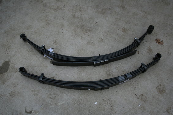

Then I decided to lift it and throw some 38's on there. I ordered the 6" Skyjackers:
http://www.supermotors.net/getfile/2...ize/leaves.jpg
And began installation.

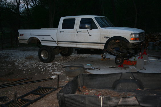

As soon as I had everything ready to install, I decided I wanted 46's. So I made a shackle flip kit and did a shackle reversal in the rear.
However, while deciding this, I thought my truck was too long. So I hacked the rear off to make a tryggy of sorts:
Then I finished everything but the driveshafts & tires:
And immediately decided the stock D60/10.25" weren't going to last more than a month. So I got Rockwells, rebuilt them, threw a locker in the front and welded the rear, and then installed them.
So now you know how I got here:
