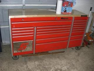

Got it today. Not to tough of a job. Hardest part was removing the bolt that holds the spring to the actual shackle. Ground off rivits with angle grinder, and used air hammer to drive them out.
Things that did make my job easier:
I removed my rear tank last year and never put it back in.
My 7,000# Rotary Lift
And the tools in this bad boy:
