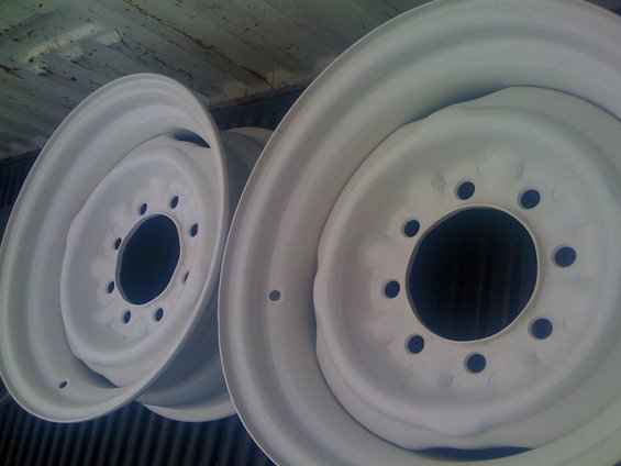

Here are mine that I did about 4 months ago. If I had the time, I would have blasted them first with Black Beauty and then primed and painted them.
I was in a hurry and just wire brushed them and sanded them by hand. The wheels were in real good shape to begin with.
I then used about 3 coats of a multi-purpose primer, wet sanded them and then shot on 5-6 light coats of acrylic enamel with a hardner. After they were thoroughly dry (sitting out in the sun for about 2 weeks), I then wet sanded them again (only because I got some runs - it's hard not to) and then finally rubbed them out with a little compound.
If I had to do it all over again, I would take them to my friend's powder coating shop and have him do it. $40 bucks a wheel for sand blasting and powder coating with a 2 step base coat - clear coat. Would have turned out just as nice and would have been much more durable.
As careful as we were re-mounting the tires, the inside hub area still got some chips in it from the cone on the balancing machine.
