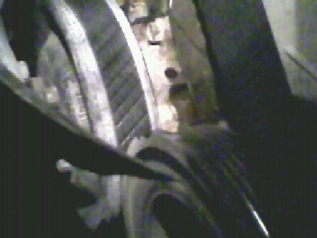

ok so i went to a friends house bout 3 blocks away for a few hours when i left there there was a large pool of coolant when i got home there was a huge pool of coolant in my parking spot i crawl under to find coolant is basically pouring out and i find that it is coming out of a hole in the block just behind the fan hub on the driver side...when its running its gushing out but when its off its stops after a little while

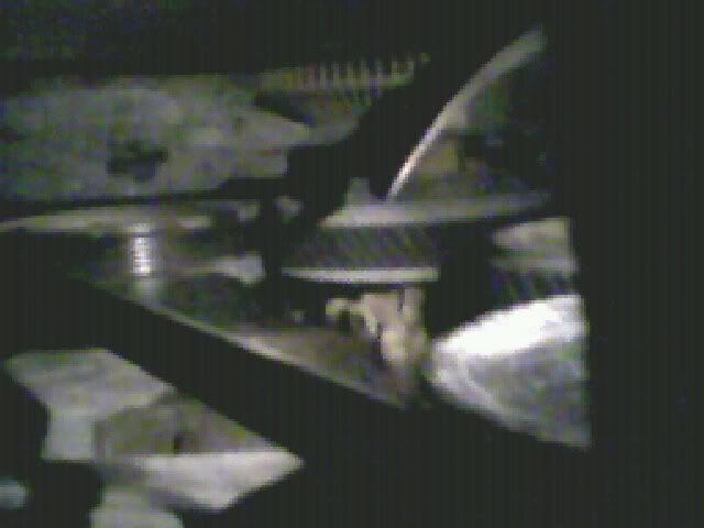

ok i got a couple pics of it for ya
this one is shot from the ground lookin up
this one from the top lookin down (its sideways haha)

Last 300 6 I worked on was the 81 f-260 I had so I don't recall the exact position of the weep hole, but if the coolant is coming out of that hole and that hole is in the pump housing (looks like it is in the picture) then you need a new water pump.
Did you check for play in the shaft while you where out there?
