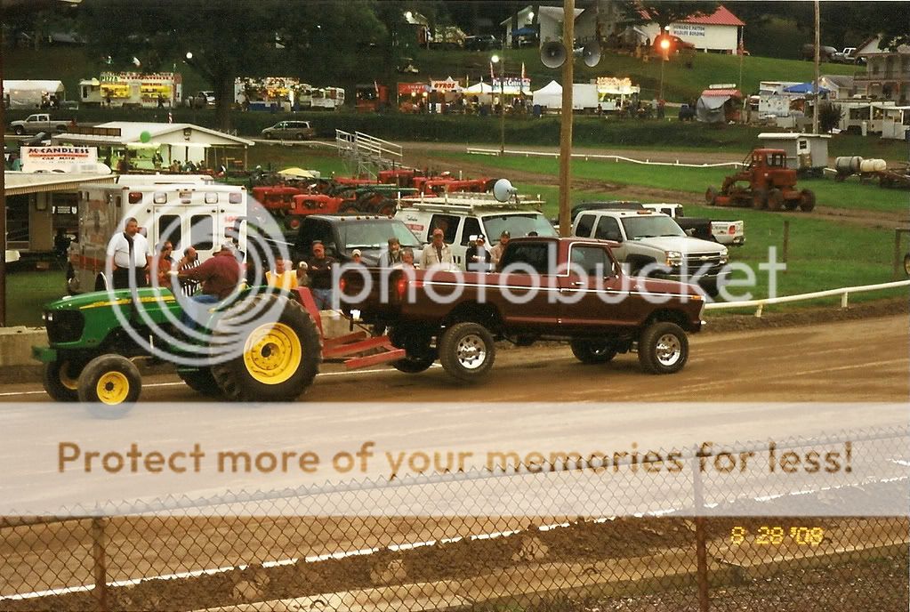

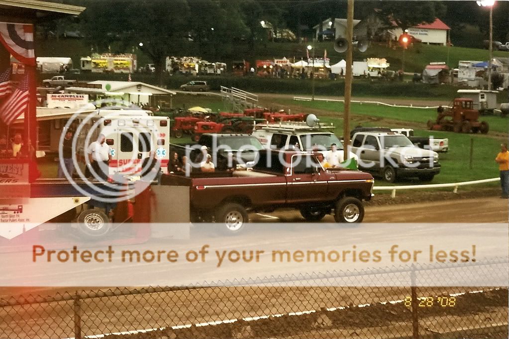

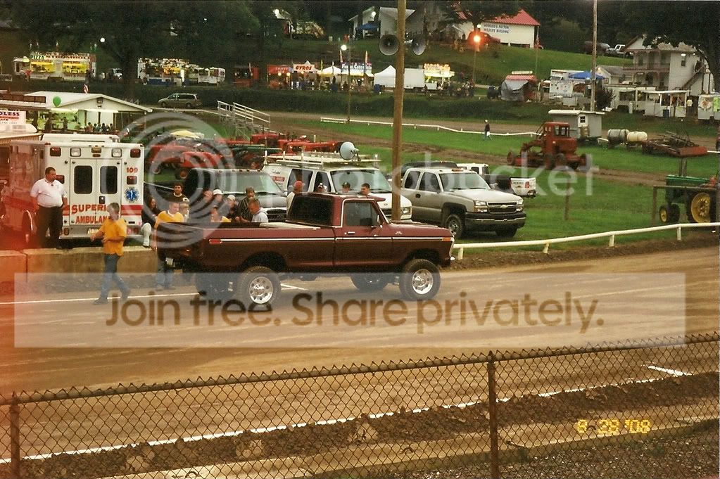

Thanks.... it is a lot of fun... and work. And yes, if I may brag a little it does sound awesome . Sometimes I fire it up in the garage just to hear it at cold idle and smell the turbo blue.....ooooo baby.
Here's a couple other pics I just found that were taken in fall '08.
Hammer down... wasn't good run at all, truck was hopping bad and I should have pushed in the pedal on the left, but my foot stayed planted on the one on the right, but I knew I was close to the lead, and, well...
Twisted the pinion off.... notice the pool of fluid under the rear end.
got a ride back to the trailer
