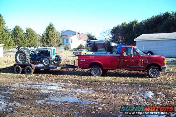

Well, since we're trading truck and tractor pics...
This pic was taken back around christmastime, but I just got to actually pull what you see above last weekend to a BIG tractor show in central PA. I think my truck did fine pulling it (4500 lbs for the tractor, estimated 2000 for the trailer), but that was the first time I ever pulled that tractor. Well, I've pulled it before, but always behind my dad's Excursion.
I've got the 300, M5OD, 3.08 gears and 31" tires...even with all that against me, I still managed to maintain 55 MPH in 3rd gear at around 3200 RPM on even the steep hills. I'm not sure how well the M5OD is gonna hold up in the future, but I figure if it breaks, that'll be a good excuse to find a ZF! I'm also very likely in the future to get some shorter gears, partly to take some strain off the rest of the drivetrain, and partly to make pulling out of intersections not so much of a chore for the clutch.
