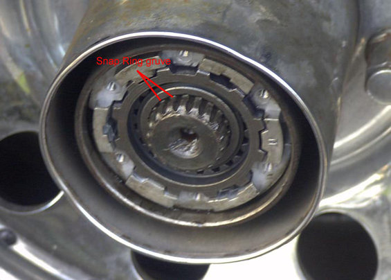

Found this answer for you
The answer is no.
That spacer & inner C-ring are there to hold the axle stub OUTboard, so the u-joint remains aligned between the ball joints. Most manual locks won't fit over those parts, so they must be removed. But that function is performed by the E-ring that goes here:
So as long as you install that ring, the stub axle will be in the correct position.
Here is the full write up if you have any other questions:
Manual Hub Conversion

ok so i need to use the axle shaft c clip also that came in the box?and that goes where the red arrow is pointing in the pic on the axle shaft?
Yes...................
It only holds the axle shaft from sliding in.

had both sides done in less than 30 min,great instructions thanks for everyones help
