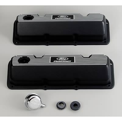

i just got a new set of valve covers from ford racing.
now, can i get a pcv valve for these that is just a single inlet, not the F looking ones i see everywhere?
like that^
i dont know much about this system, just why you use it and how to hook it up.
also, if you have an aftermarket air cleaner, where could i run a hose from the breather on the opposite valve cover? i think it kind of will look weird with nothing going to it. i dont really wanna get another breather because i like the ford racing logo on it.

You can get PCV valves like that; I've seen them at Autozone, etc. For the breather - what you usually do is get a special breather cap with the filter built in. That eliminates the need to run a hose up to your air cleaner since the filter is in the actual breather cap. I got mine from Summit and it has a Ford Racing logo on it.
