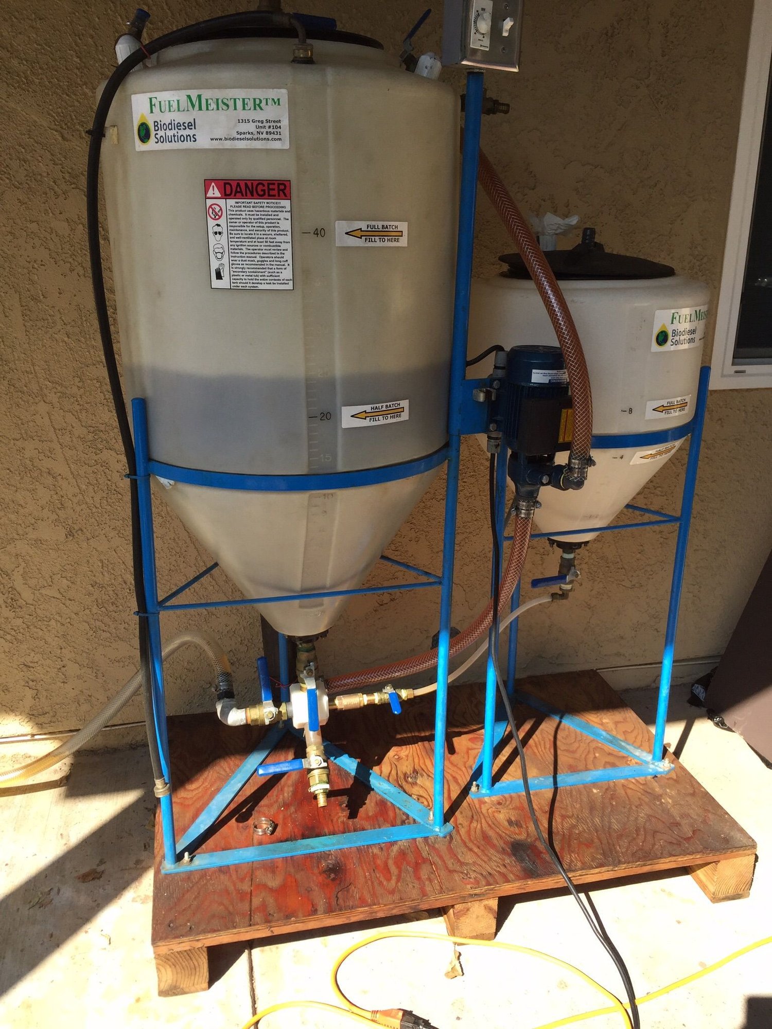

My last 4 gallon bucket batch was a success, passing all tests and running fine in my Beast at about 10% ratio, so time to go bigger. This is a 20 gallon batch. Oil settled for about a month, then titrated to 2.0. Passed HPT with NO bubbles. Fingers crossed for a good result!

30% ratio running now... so far, so good. Keeping fingers crossed!

that's a good ratio for winter, about what I run as long as it's above zero. Keep an extra fuel filter in the truck with you, it will remove crap from your fuel system. I had to change filters more frequently at first...
