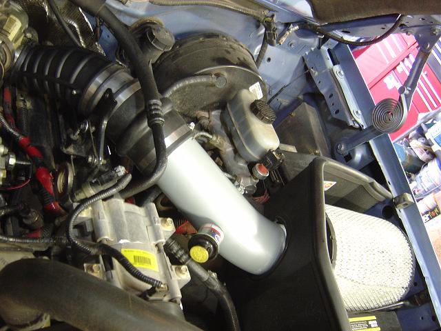

Neal, I modded my aFe airbox to fit the 6637. It only took a little cutting and bending. I also like the idea of isolating the intake from engine heat, and dust. I'll try to find a pic.

Here's the best I can find on my work machine. It even shows the hose you sent me, Neal!
