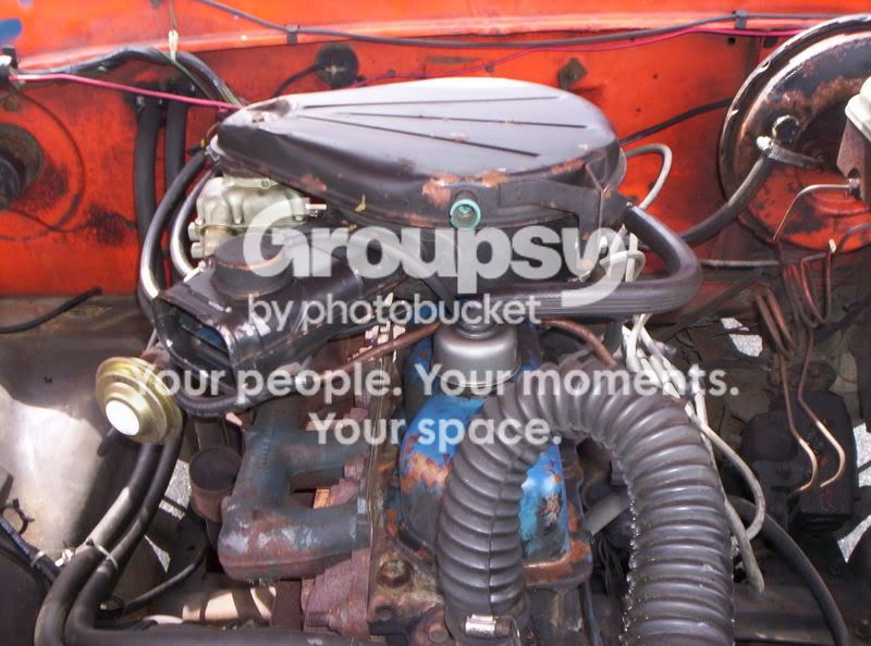

Hey everyone,
I'm new to this site and looking for some input. I've got a 78 F100, owned it for a year now. It currently has a 300 straight 6 in it. It's a fantastic truck however it's engine and tranny has become tired and will need replacing. Neither have been worked on in 30 years so what do you expect.
So i'm trying to decide which engine would be the best to swap with. I've got some connections and can get a rebuilt 351 windsor as well as a tranny for $1000. Would this be a good engine for this truck? What other modifications would be necessary? Would a need a new carb and rear end as well?
Or I could just get another straight 6. This route would cost more for the engine and tranny, probably closer to $3000 with no labour. But, I wouldn't have to do any other modifications. My issue with the 6 is that the one I currently have has zero power. Probably because its old and tired but I dont want to put a 6 in and end up with no power. I'm a city driver though, the truck wont be used as a truck very often.. So maybe a 6 would be better for the city?
Anyways, as you can probably tell I dont know awhole lot about vehicles (yet). So any help, hints or tips are appreciated! I know the basics, thats about it. This truck is my learning truck and my long term project.
Kim

One more question.
My truck is arm strong steering. I dont mind (usually), it's only an issue when I need to parallel park in small spaces. Is it worth it to switch to power steering or would it be too much of a hassel?
Heres some pics of the truck.. Just for fun

We've done a major tune up, had everything looked at/changed.
Honestly, not sure what exhaust is on it, all original. Oil pressure and compression has been checked.
Power isn't the only issue. The engine is a pinger. It makes noise, knocks, pings... Runs better with supreme gas but still not great.
We've got provincial emissions testing here as well called aircare. The truck failed aircare it's first time through. Had insanely high Hydrocarbons while idleing but passed while driving. Basically the engine has a bunch of crud in it that settles while idleing (causing awful emissions) but gets burned off while driving.
I'll also add that I dont think it was taken care of when i purchased the vehicle... Had no coolant, desperatly needed spark plugs, oil chage and new filters. So it's been beated up a tad

I dont know the specific issues with the engine, I would like to figure it out to.
Basically, engine lacks power, knocks (especially up hills and accelerating) and it jumps back and forth between gears (only up hill and accelerating).
The engine is also difficult to start in cold and the choke likes to be out about 1/2cm even when warmed up. Tried adjusting the carb, didn't make much difference.
My shop said the engine seems to be tired but hasn't had time to pinpoint what exactly is wrong with it. Either way, it'll need a rebuild
I haven't done awhole lot with the truck yet, as I said I'm still learning. So far it's had a full tune up, new hoses (upper rad hose), new alternator and a fan belt.
