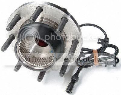

Oh I am going to change the locking part out to Warn very soon. They are on the list for my upcoming birthday gifts.
The hubs that I am replacing are the main hubs that bolt to the knuckles.

Ouch! Now I get it..... A picture really is worth...
Good luck and let us know how tough this installation is.
