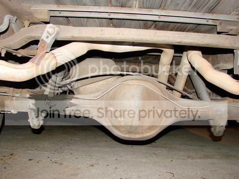

well the only number i saw was a 10. Heres a pic of it. I was hoping to go the cheap route like goto the junkyard and pull something out. so i would have to find something to fit a 9" and match the spindles? how do i determine how many spindles there are?

Odd's are good that what you have is an 8.8" light duty axle with 2.73 ratio gears and an open differential. Being an '82 it could be a 9" instead. If your lucky you still have the identification tag on the cover. You can also use the code from the door sticker, if it's still there, to determine which...provided that it's original.

that looks like a 9inch to me. no bolts on the "cover" because it use's a center section that pulls out the front, just like on truck axles. Pull your axle shafts out, measure, the diameter and spline count. Take a trip to the junk yard, match spline an diameter, count how many turns of input yoke to axles to get your gear ratio, take home and install. to install; remove axles, remove old center section, seal new center section, install center, and install axles.

No Question about this one it is definitly a 9-in. Part are everywhere for these just make a wish list and can get about anything for it. Down here you check around at the dirt tracks and get all kinds of stock diff's becaust a spool only cost $150 so if they can get that or close to it for a posi they get less wieght and locked rear just a thought
