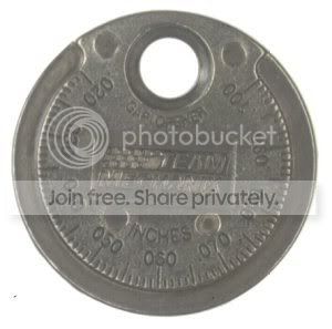

gapping is when you adjust the size of the gap between the electrode and point on a spark plug. most plugs you buy in an auto parts store are pre gapped so you shouldn't have to gap them. some plugs however need gapped before installing them. for this you would need a tool known as a feeler gauge, (i think). it looks almost like a silver dollar, and has markings around it with an edge that escalades for a larger gap.

The tool for plug gaps is called a plug gapper and it is typically made of pot metal as shown above. A feeler gauge is a precision device made of high quality steel and is usually hard chromed to keep it from changing thickness with use.
