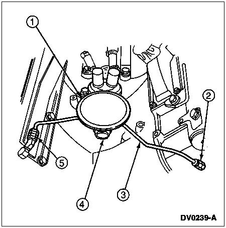

Cali models have a fuel pressure pulse damper on the FP vs none on the reat, 49 states pump.
Califoria pump
49 state pump
