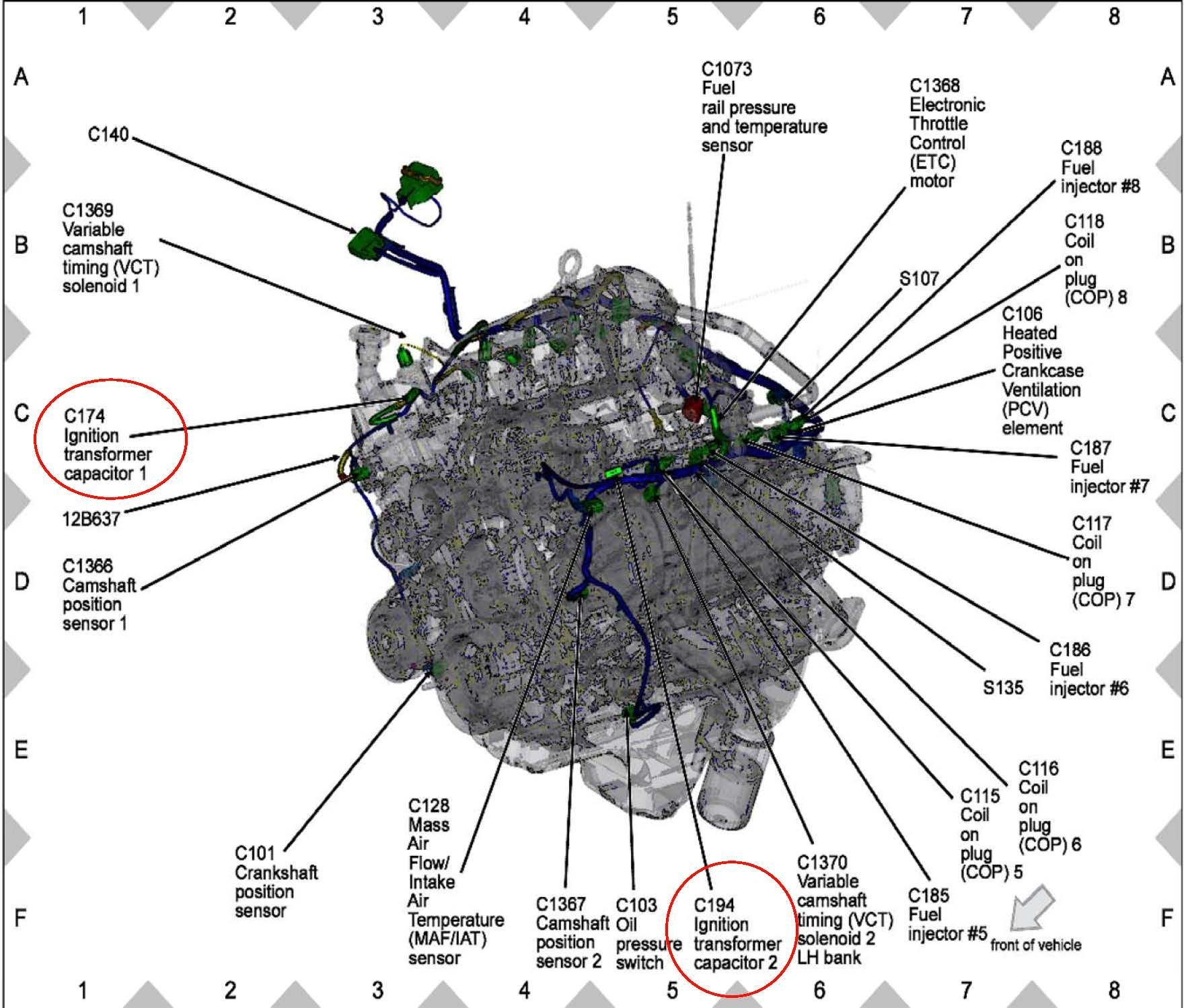

Check the 2 ignition capacitors shown in this diagram. Their job is to filter out the noise you are hearing.
