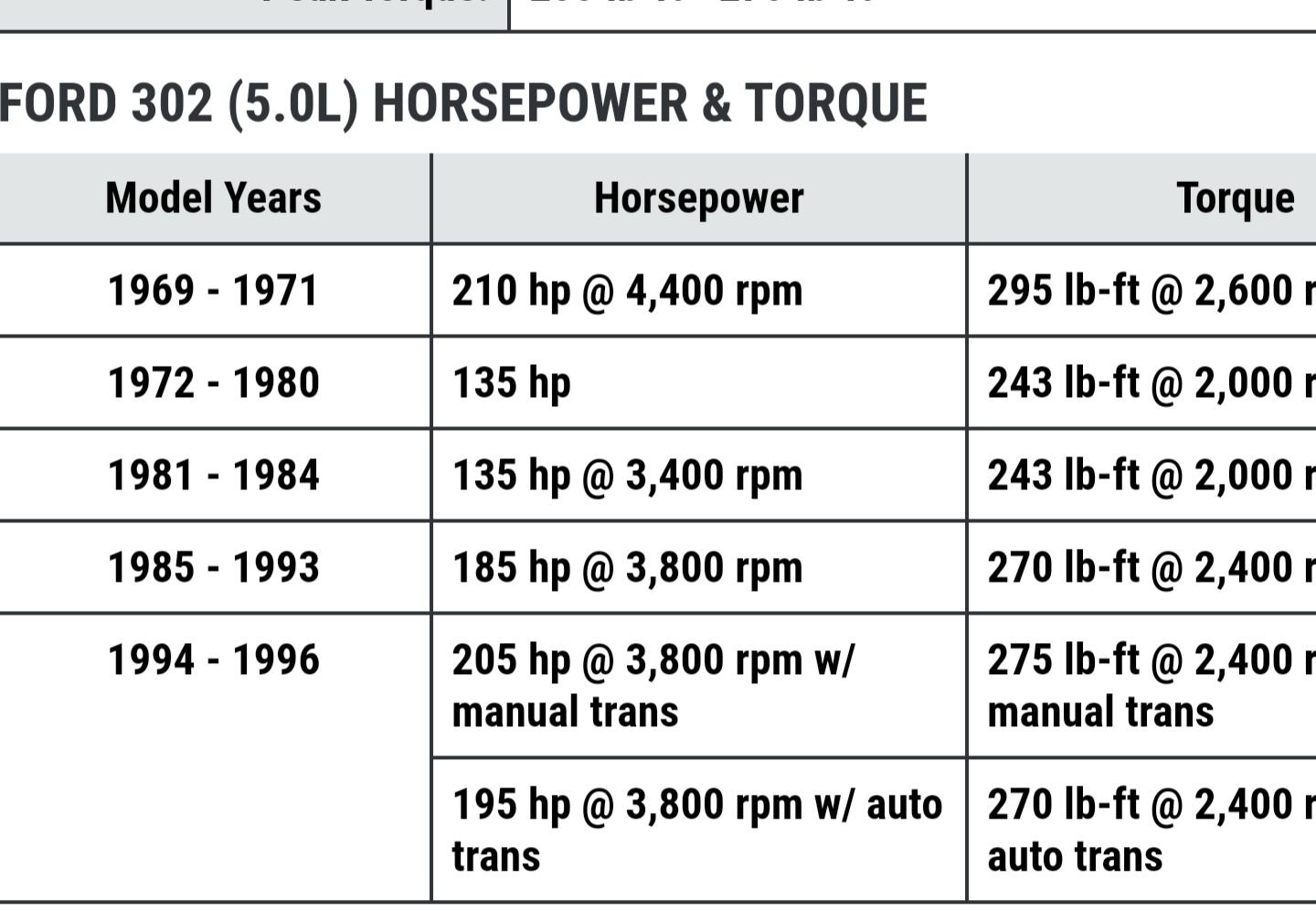

Oddly enough, the 5.0 manual trucks with speed density in 94 and 95 were rated at 205 hp and the auto mass air trucks were rated at 195.
as they had everything else the same, it would have been in the tune alone.

You are right, not too noticeable. But odd that the "less accurate " speed density made more power

I suspect there is no significant difference in the actual power made at the motor, MAF usually runs a little richer than SD so not likely SD makes more power. But a manual trans consumes less power than an auto so it's not that the manual truck makes more power it's just that less of it is lost in the powertrain... and the marketing Dept works that backwords and comes to the wrong conclusion.
